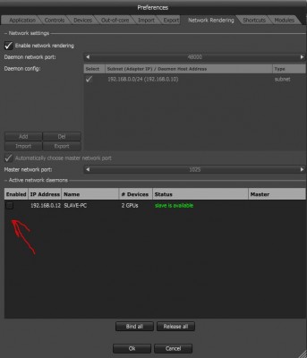

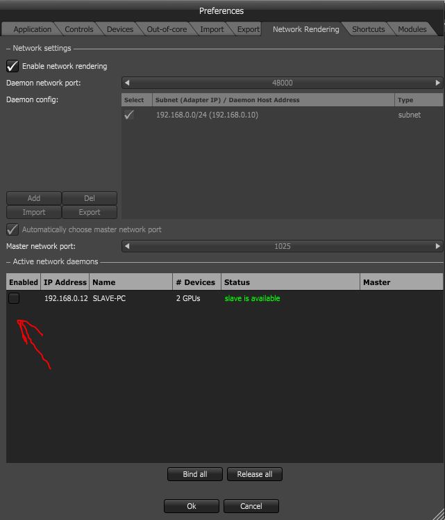

I have to manually enable the slave in my network as it is not checked when ever I start Octane. The slave is listed but not enabled.
This is new as I never had to enable it before. It was enabled automatically before.

Zay wrote:I have to manually enable the slave in my network as it is not checked when ever I start Octane. The slave is listed but not enabled.
Yes, I can confirm, that the loading of the selected slaves got accidentally deleted in 3.07 test 4. It will be fixed in the next release.
