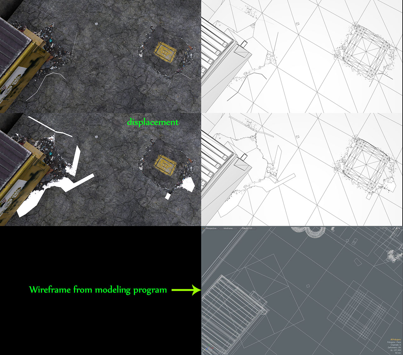

It's time to get the intersect bug fixed. It's long overdue!
Again - a model I have to scrap because of this.
This is from a scene I should have used. Top view. Octane creates lots of cracks in the geometry where the geometry intersect.
Adding displacement on top of that and things goes from bad to worse.
Can you please fix this?
Win 11 Pro | i5 12600K | 32GB ram | 2x GTX 1080Ti + 3080Ti - studio driver 581.57| Modo/Blender/ZBrush/Daz/Poser
Hi Zay,
please, share an uv coordinate pass, you cannot have overlapping uvs with displacement.
ciao beppe
ciao beppe
Then that needs to be fixed toobepeg4d wrote:Hi Zay,
ciao beppe
We can't have a rendering engine where modelers need to take special care to Octane before they sell it to the world.
