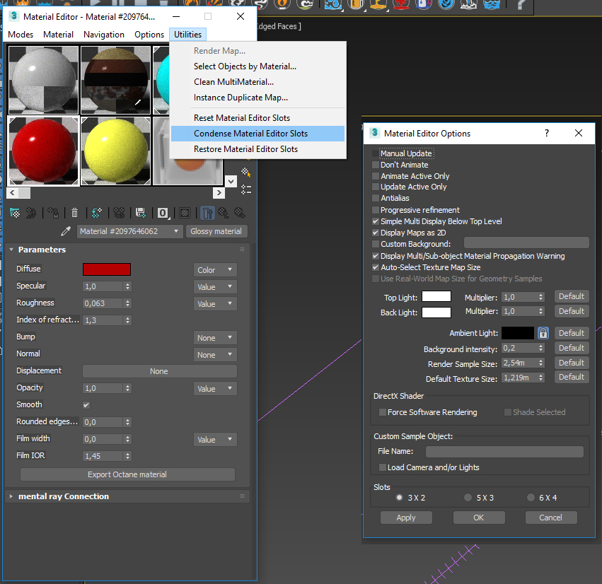

You could also clean your material editor slots from unused materials and set manual update material preview.
Regards
Paride
Regards
Paride
