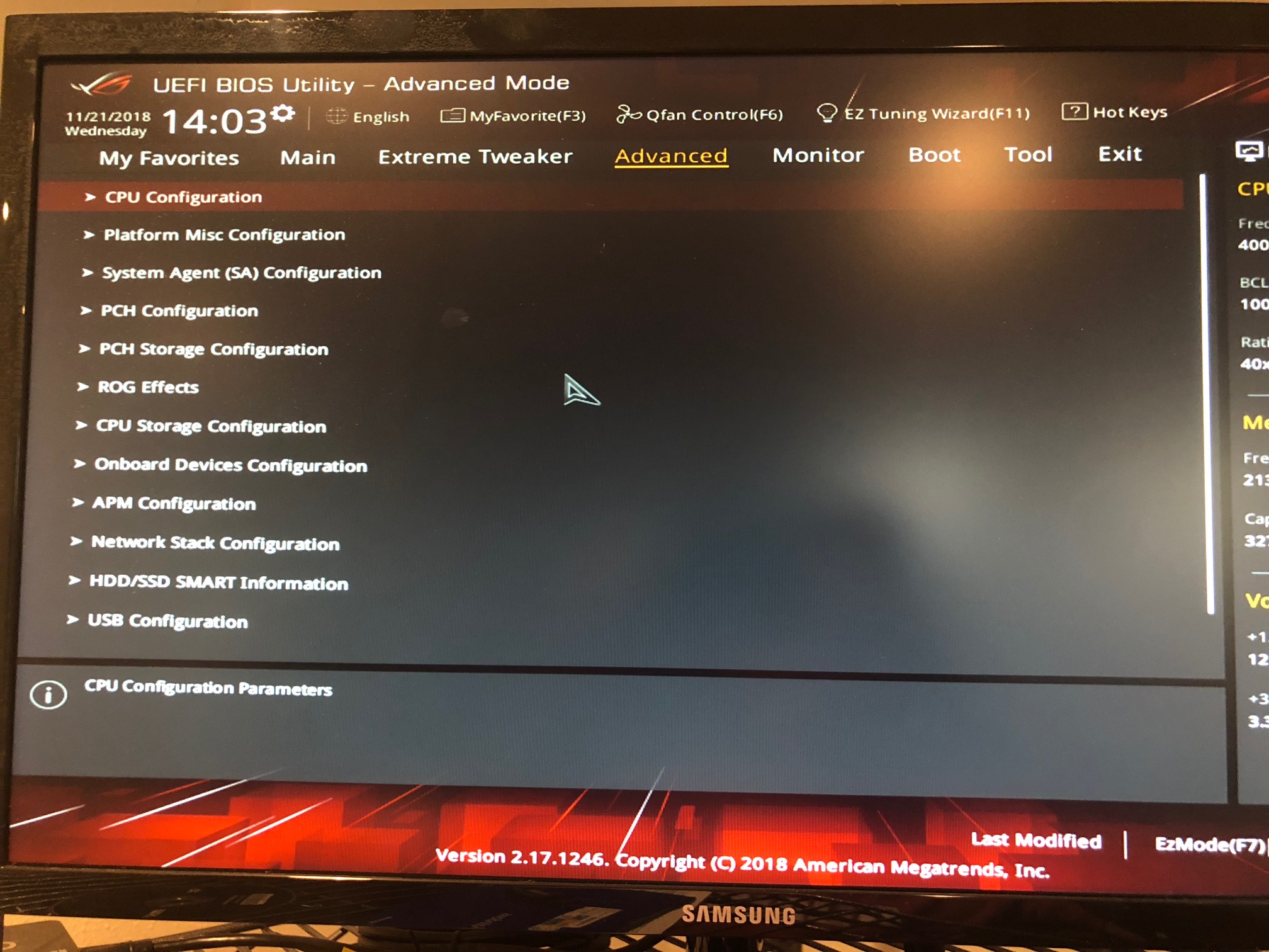

As you can read in the links above some people have been able to resolve this issue with a BIOS update by ASUS some others by tinkering with voltage settings in the BIOS, which I dont recommend to do unless you are very experienced in the BIOS.

In the meantime, do the following: Look if you have Intel Turbo Boost applications installed on your system, if so disable them and deinstall them.
Then go into your bios and disable the CPU turbo completely.
If this workaround helps you and you dont have any crashes anymore then its proof that its the same problem as all others have.
