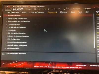

I emailed tech support and uninstalled intel turbo boost. Do you know where is it located in the bios? Thanks

back in the days, when I built several systems based on X99E 10G WS, running flat 4Ghz on CPU preventing from going up or down was actually helping with stability (and also improved OctaneRender speed, since our program do not boost CPU into higher frequencies and when needed most of time it was sleeping). This could be done in CPU tweaking area.
