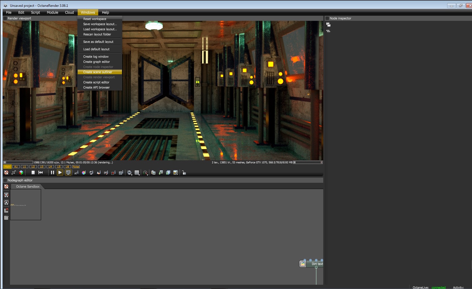

For now, please create a new scene outliner window:

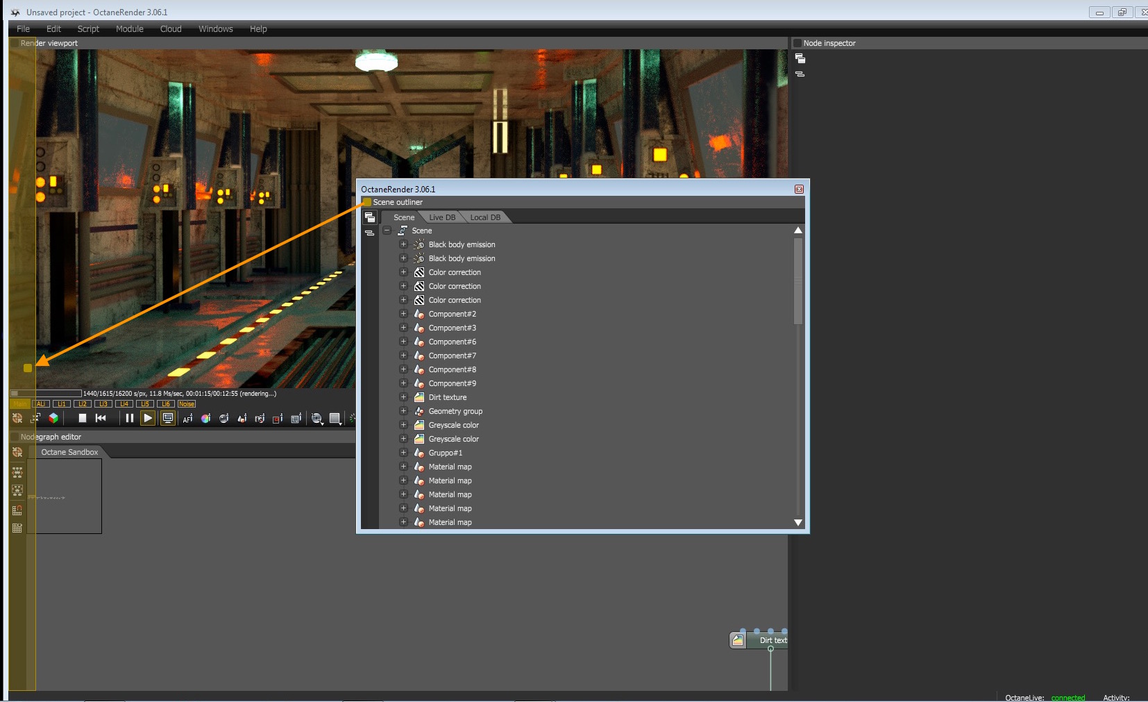

Then place it where you want in the interface:

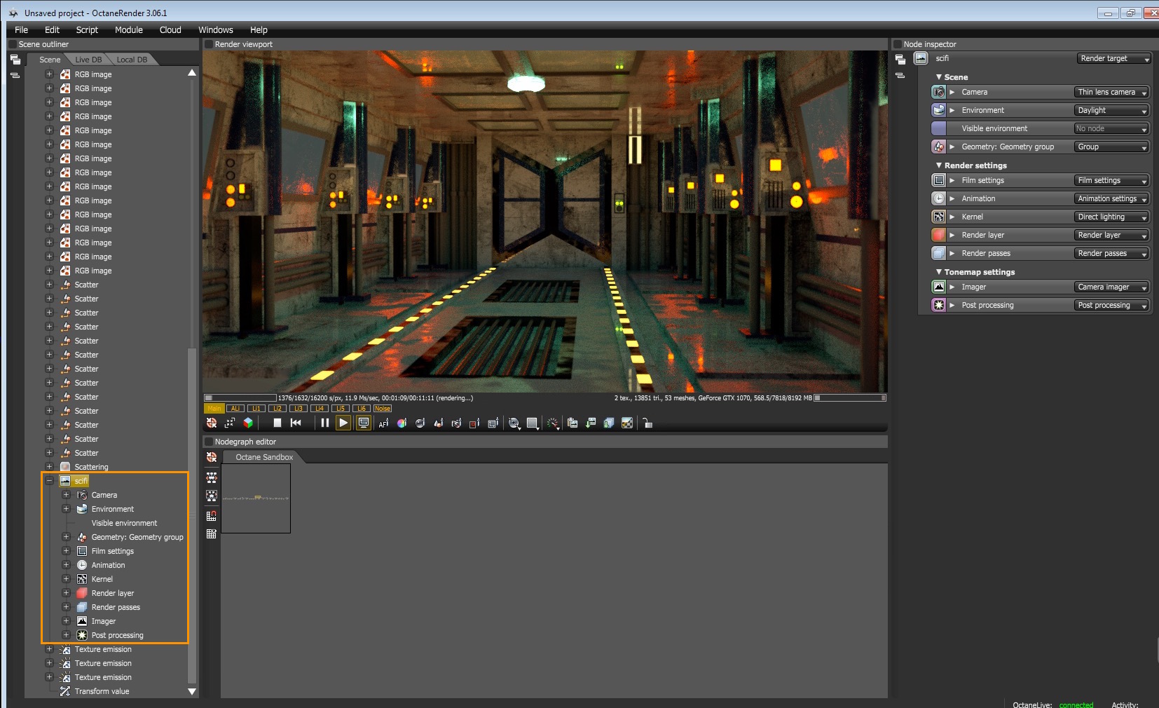

So now you are able to locate the Render Target node, changing its name, and more easily acces to the sub nodes:
