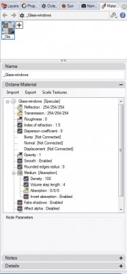

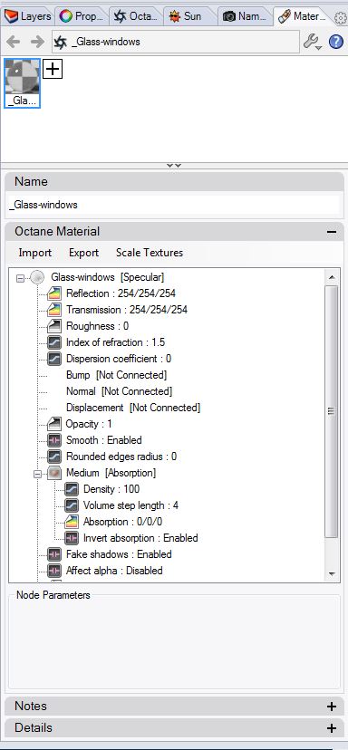

Can you post a screenshot of the glass material setup pls.
Paul
formatio
Posts: 131
Joined: Sun May 18, 2014 11:00 am
Location: EU
Hi guys
The material looks like this:
The two options that are below the edge are film width: 0 and film IOR: 1.45
One thing thou - that I think has no effect - is the absorption medium - is set to black so doesn't absorb anything (it shouldn't be there, I think that v3 adds it by itself (materials were created and saved with v2))
