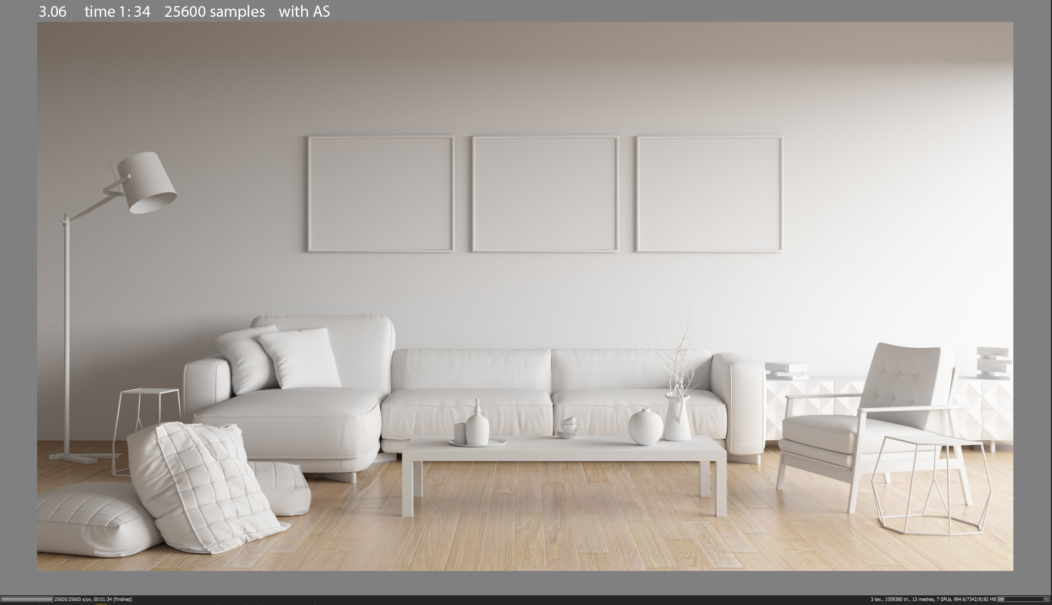

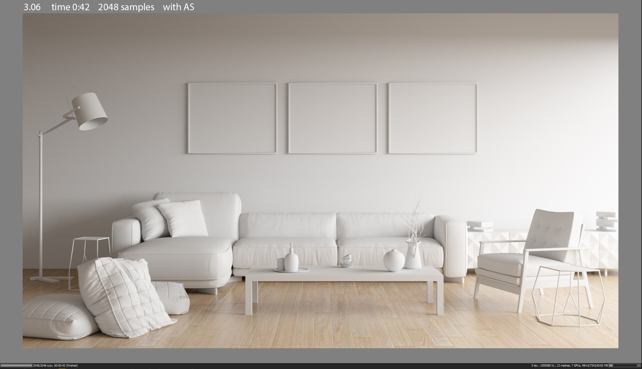

Ok here are my initial tests, Adaptive Sampling does work just fine as you will see below,
All these are rendered with 7x1080's watercooled 2x Xeons e-5 2640 v4, at 1920x1080, pathtracing of course and the scene's only light source is a window with a light portal on the right and octane sun and sky env. Tems at max reached 44 C in a fairly hot room of 23 C with complete silence from the machine. also a shout to Smicha who build it ! I also did a super clean render at 8192 samples followed by the same quality with AS.

So 1:16 reduced to 0:42 ....

And 4:17 to 1:34!!! At a complete noise free image more than 3 times faster than 3.05!

Any particular settings for AS?

noise threshold to 0.038, min samples to 512 and power to 1, and up the samples a lot 25000-50000. It starts slow but it goes crazy fast after sometime!

Thanks for those tests ;) looks promising!
