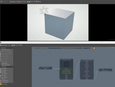

I've tried with your latest assembly and it still doesn't work. I just can't figure out why. :oops:
I even uninstalled my Octane VR plugin (which was the latest available by the way) and installed the demo version of the regular modo plugin. But stil no success.

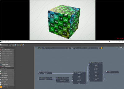

First I've tested the box projection which works:

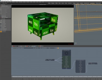

Then your newest assembly:

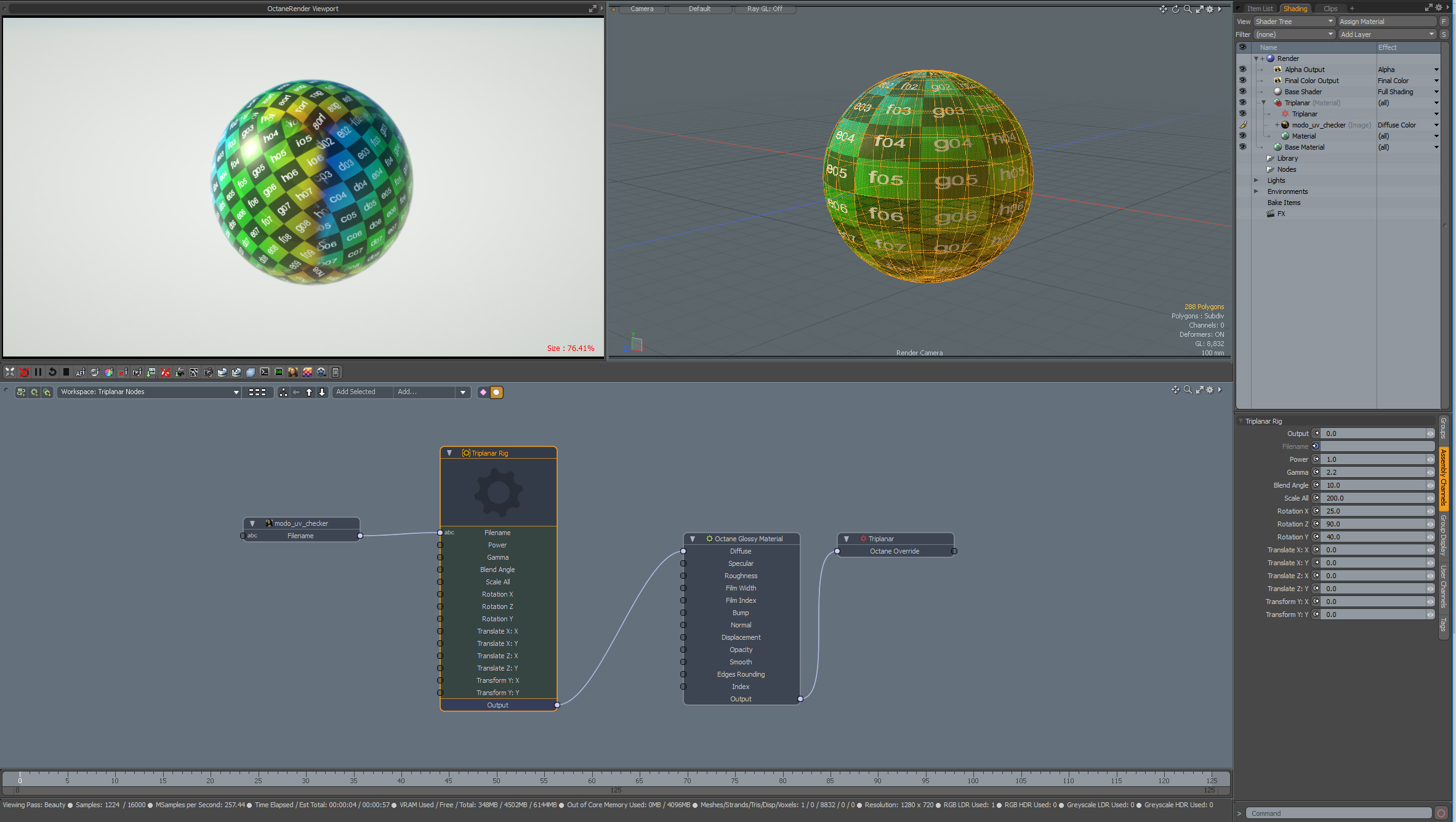

since the new triplanar option in Octane is not as convenient to use as it should i made a small assembly. Now you can plug in one Imagefile and control the scale and rotation and also translation in one location.
I made this in the Octane Test 2 Version of the Modo Plugin, but when i load it in another scene I get Cuda Errors. But it works fine in Test 1.
I don't know if this is a problem with the plugin or with octane itself.
I hope you like it!
