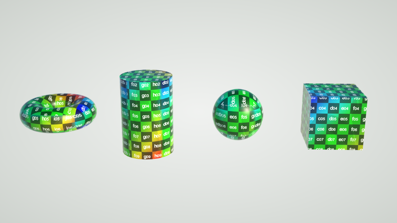

here is a little test i would like to share with you. It's a triplanar mapping rig which makes use of the new Falloffmap options:
I think it works very well. You can use the same Texture or a different for every direction. Also you can rotate, translate and scale every direction seperatly and adjust the falloff between the textures.
My only problem is to make a nice assembly out of it. Maybe you guys could solve this.
I hope you like it!
Edit: It is not possible to use this for Normal or Displacement. But you can UV the object and bake out the Texture
Triplanar mapping in Modo

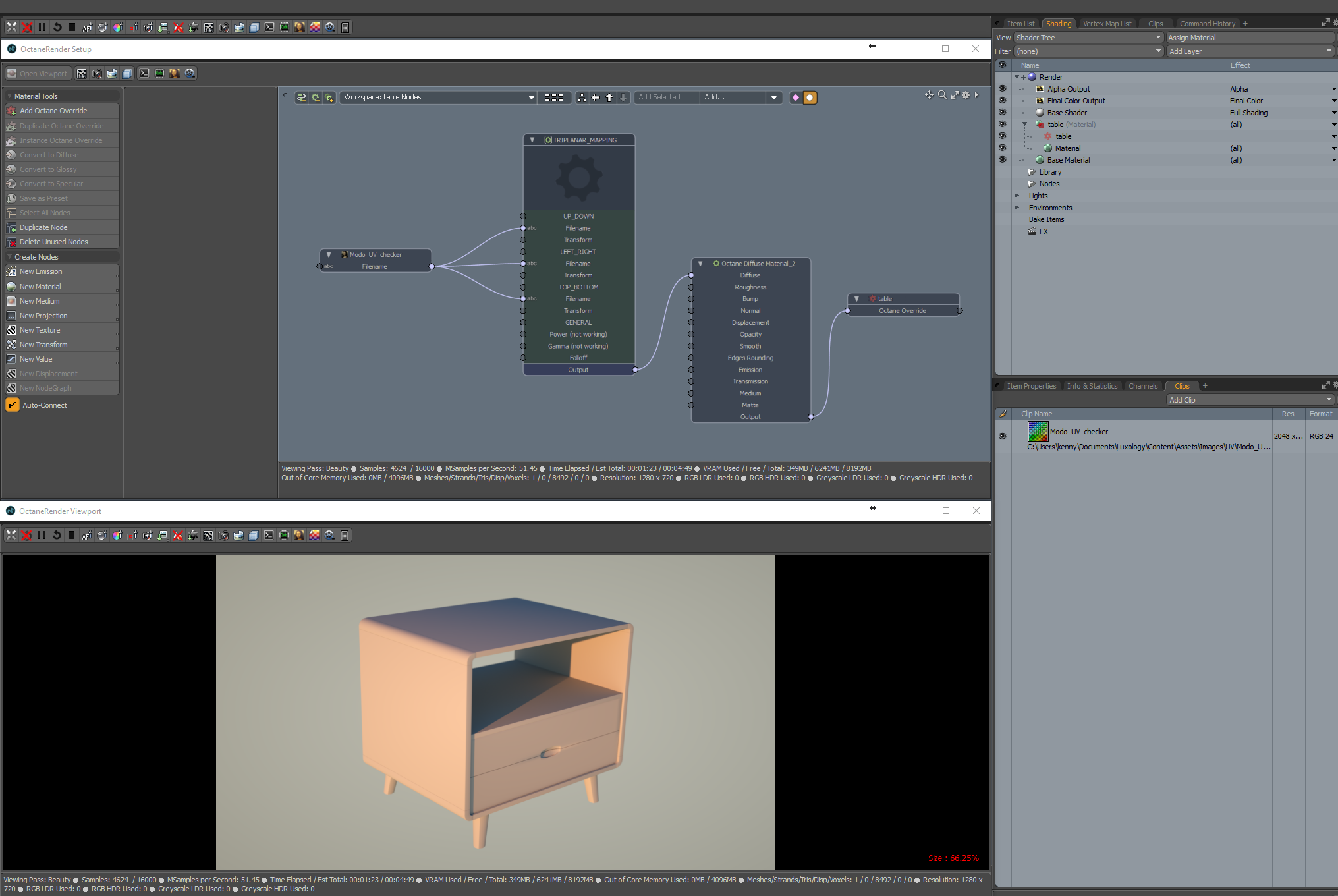

Hi guys, I'm having trouble getting this to work. I'm following the video step by step but it doesn't work.
Can you figure out what am I doing wrong?
(Modo scene and screenshot attached)
I'm on Modo 10.2 with Octane VR 3.4.3.
