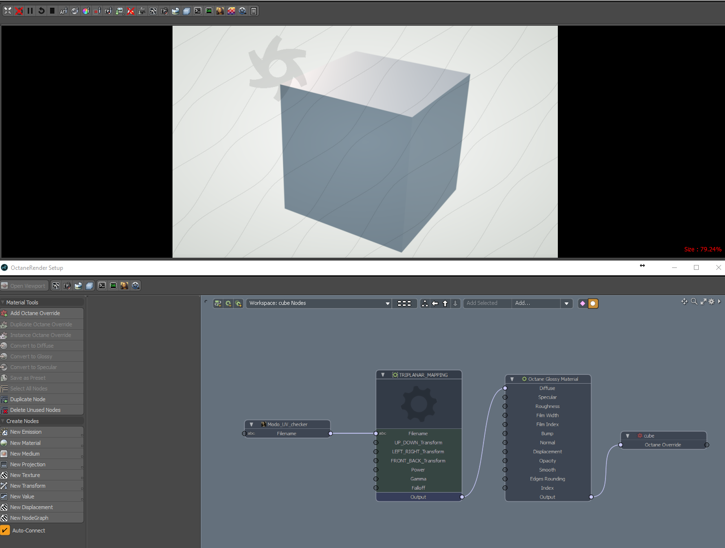

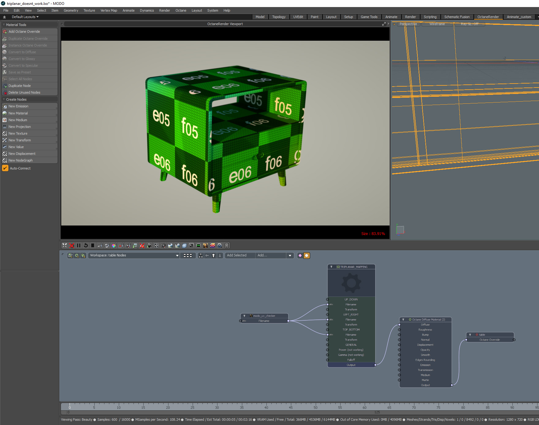

Hi Hesekiel. Thanks for your time to check this.
So are you saying my scene works for you? Now that is very interesting.
I've tried with your latest assembly and it still doesn't work. I just can't figure out why.
I even uninstalled my Octane VR plugin (which was the latest available by the way) and installed the demo version of the regular modo plugin. But stil no success.

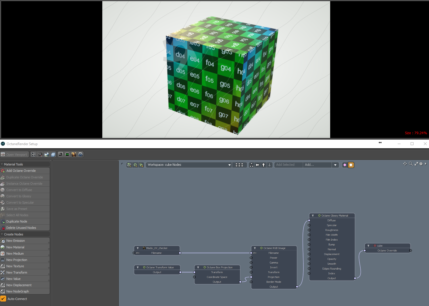

First I've tested the box projection which works: Then your newest assembly: What version of modo are you running? Mine is 10.2v1

I suspect the VR version of the plugin does not contain the code fixes needed to make this work. Try this version....I even uninstalled my Octane VR plugin
https://render.otoy.com/customerdownloa ... IPTION.exe
Paul
The demo is potentially too old to contain the fix needed for Triplanar mapping to work too.My last screenshots are from the regular octane plugin (demo)
Paul
Wow Paul, that is right!
It works with the new one! I should have tried it before saying that it won't work.
Great stuff! Thank you for your help. Now I feel special with this non-official version
