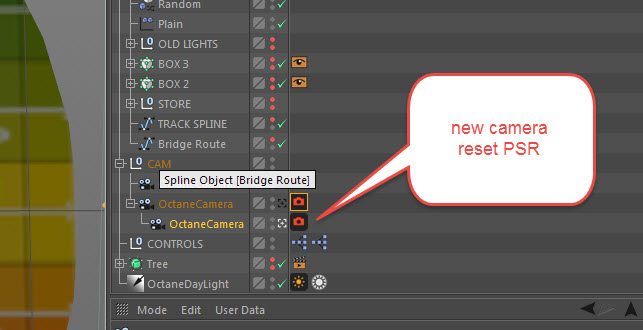

There is some weirdness on camera as i can understand. It jumps and rotate random.
After some tests i found how to fix:
Create new octane camera, put as child to yours. Reset PSR to match.
Somehow your camera keeps jumping. I'll check more. Also don't put objects tags to every objects. It just make slower the all process. I know it's done by despair but it's like this.
