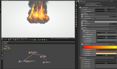

Step 1 - Set the proxy mesh up in Octane Standalone. You MUST connect the geometry to a Geometry Out node (and potentially add a Placement node between the mesh and Geometry Out).

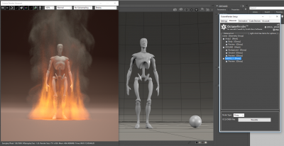

Step 2 - Add a prop into the scene, and change it's type from Mesh to Proxy, and then load the proxy OCS/ORBX saved in step 1.
Paul
