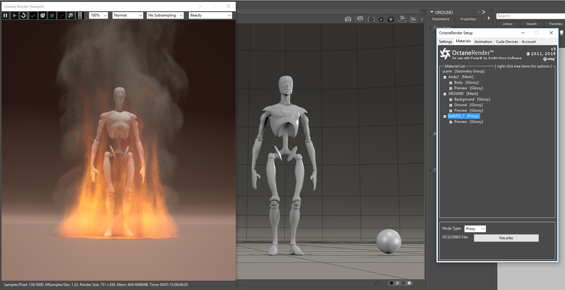

Following is a highly experimental release, which introduces OCS and ORBX proxies.
3.5.2.80
- Compiled with Octane 3.05.2

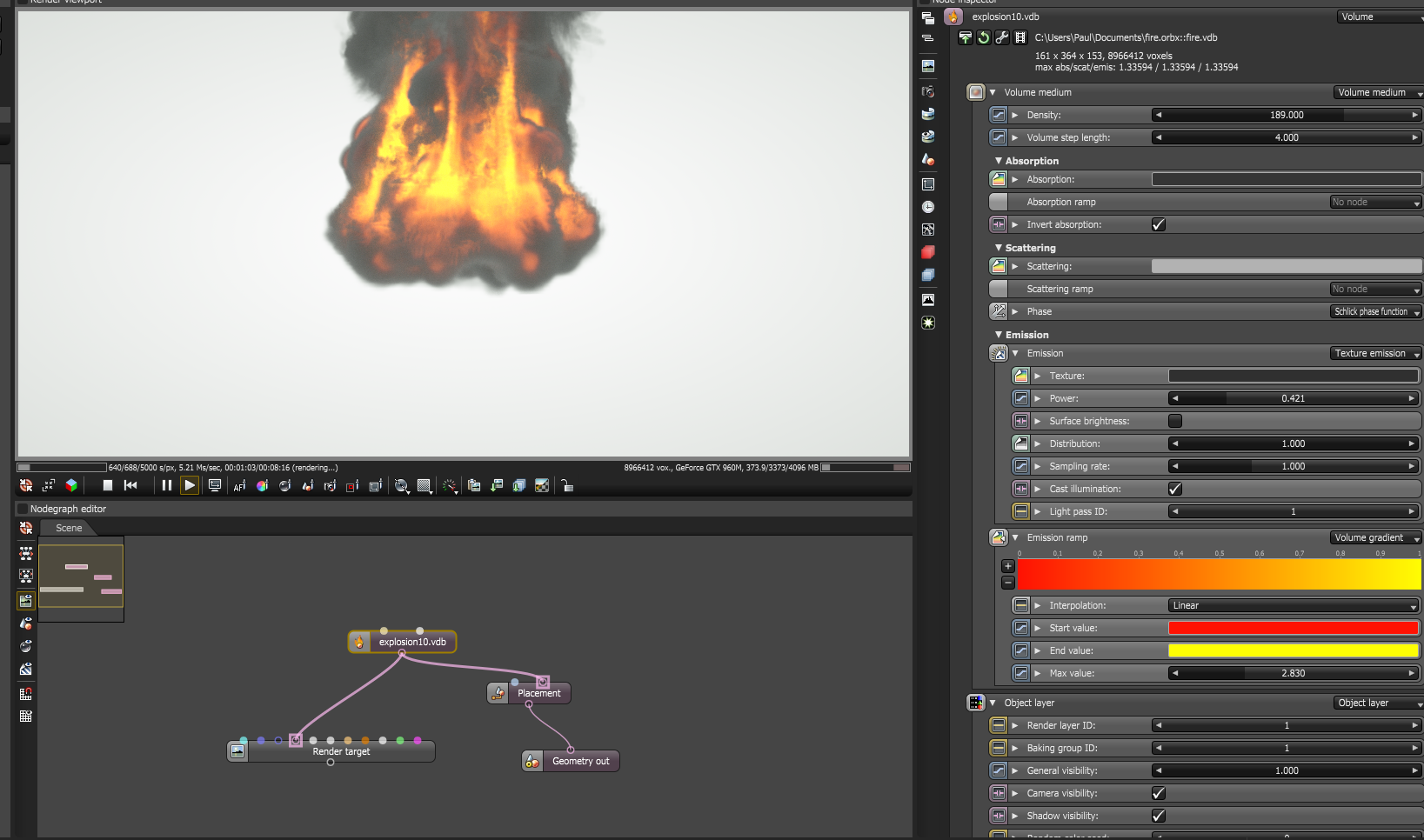

- EXPERIMENTAL: Added "Proxy" option to the Node Type combobox of meshes. Select Proxy, and then you can load an ORBX or OCS file to render in place of the Figure/Prop. The OCS/ORBX file MUST HAVE A GEOMETRY OUT node (with the geometry you want to render connected to it) in the scene. If you tick the Animation->Camera Motion Blur checkbox, the timeline inside the OCS/ORBX will be updated each frame when rendering the animation, so animations inside the OCS/ORBX file will render. You can use this feature to add VDB files into your scene. The Proxy will always for placed in the centre of the scene, so to transform it you need to place a Placement node in the OCS/ORBX connected to the Geometry Out, which you can use to scale, rotate and transform the proxy.
https://render.otoy.com/customerdownloa ... _Win64.exe
Step 1 - Set the proxy mesh up in Octane Standalone. You MUST connect the geometry to a Geometry Out node (and potentially add a Placement node between the mesh and Geometry Out).
Step 2 - Add a prop into the scene, and change it's type from Mesh to Proxy, and then load the proxy OCS/ORBX saved in step 1.
Paul
3.5.2.80

YYYYAAAAAAAA!!!!!!!!!! This is great. Oh! Paul, just to let you know you can't skip frames to render out animation with the Proxy.
It seems you have to start rendering at frame 1. If you start at frame 2 the proxy animation will not start.
