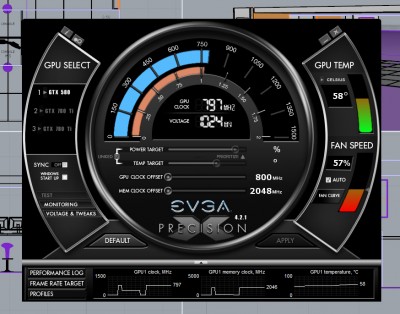

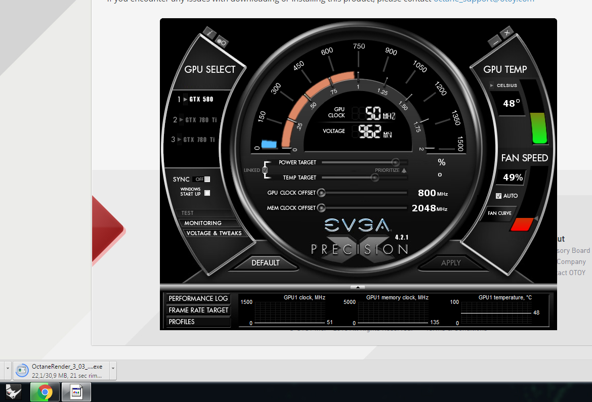

One other thing, I add two images before starting rhino and later, do you think it is normal this increased use of VGA
SORRY, MY ENGLISH IS BAD!
2 Xeon quad core E5440_8gb Ram_Nvidia GeForce 2GTX 780ti 3Gb/Nvidia Quadro K2000_Win10 64bit_Octane 3.02_Rhinoceros3D
face_off
Posts: 15799
Location: Adelaide, Australia
That screenshot is for your GTX580 card. Are you using that card for Octane rendering? If so - then it's VRAM limit will be the overall VRAM limit that Octane can use. In which case, turn on Out Of Core Textures in the plugin configuration (although you may not have sufficient CPU card to store those textures with only 4GB).

No, I do not use the GTX 580 for renderinrig, but only for video management.
The images were saying this:
Before turning rhino, the VGA was working to a minimum (although I used photoshop or other programs),
Just I turned on rhino, without rendering, without opening files, VGA works hard.
The activity you are seeing on your GTX580 is Rhino using the card for it's OpenGL viewport. You can see this in Tools->Options->View->OpenGL. It is unrelated to the Octane plugin.
