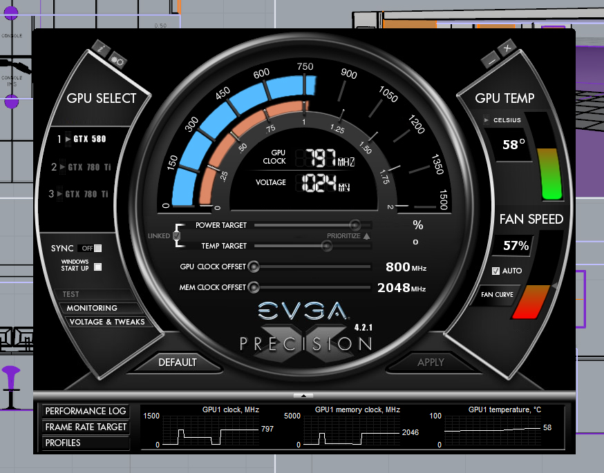

One other thing, I add two images before starting rhino and later, do you think it is normal this increased use of VGA

That screenshot is for your GTX580 card. Are you using that card for Octane rendering? If so - then it's VRAM limit will be the overall VRAM limit that Octane can use. In which case, turn on Out Of Core Textures in the plugin configuration (although you may not have sufficient CPU card to store those textures with only 4GB).

I think I might know what you issue is and it was when I saw the screen shots of Precision X. I have run Precision X for a while with a TItan X using 3dsmax, for quite a while I could not understand the issues I was having, some crashing, slow viewports, etc. I at one point removed the Precision X and realized that it was the issue all along. I had nothing OC'ed I only used Precision X to set fans on GPU. Try removing it and try again. If you need a Software for Fan control for rendering I suggest Afterburner.

The images were saying this:
Before turning rhino, the VGA was working to a minimum (although I used photoshop or other programs),
Just I turned on rhino, without rendering, without opening files, VGA works hard.

The activity you are seeing on your GTX580 is Rhino using the card for it's OpenGL viewport. You can see this in Tools->Options->View->OpenGL. It is unrelated to the Octane plugin.No, I do not use the GTX 580 for renderinrig, but only for video management.
