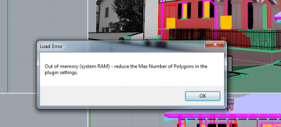

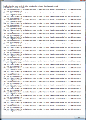

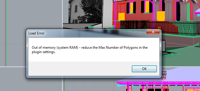

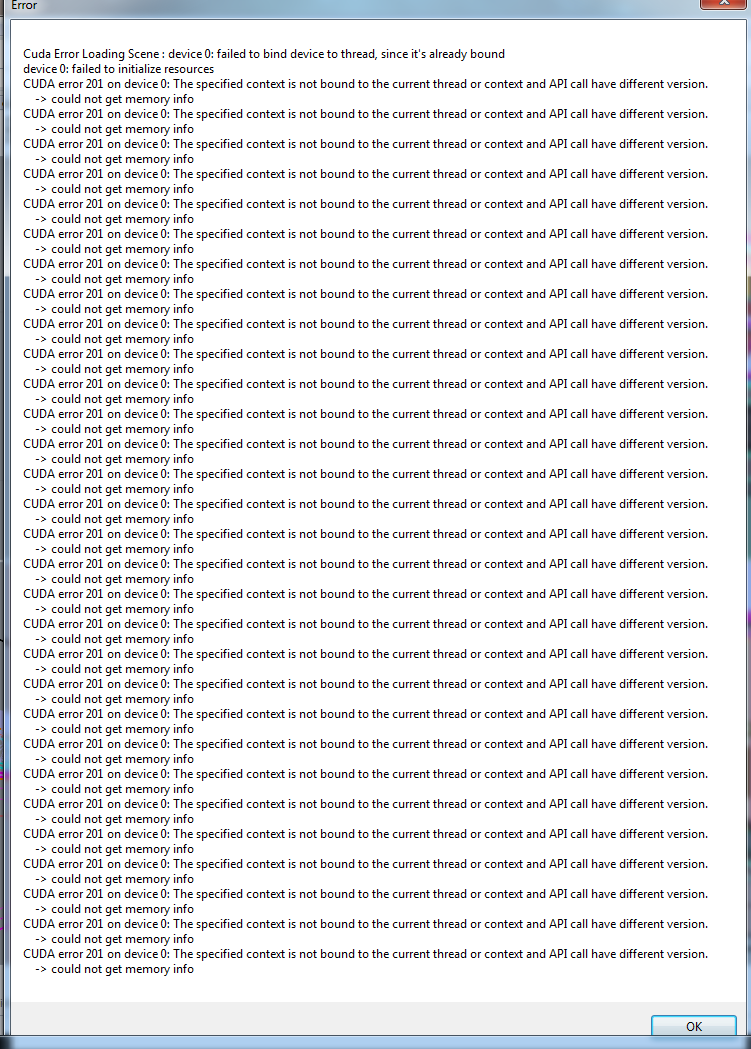

I have 2 gtx 780ti 3gb new, and when i render this scene i recived this error:

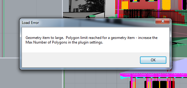

sometimes the pc tells me that I have to increase the polygons, increasing the polygons and tells me that I have too many polygons ... honestly it's frustrating !!
See image for the other errors...

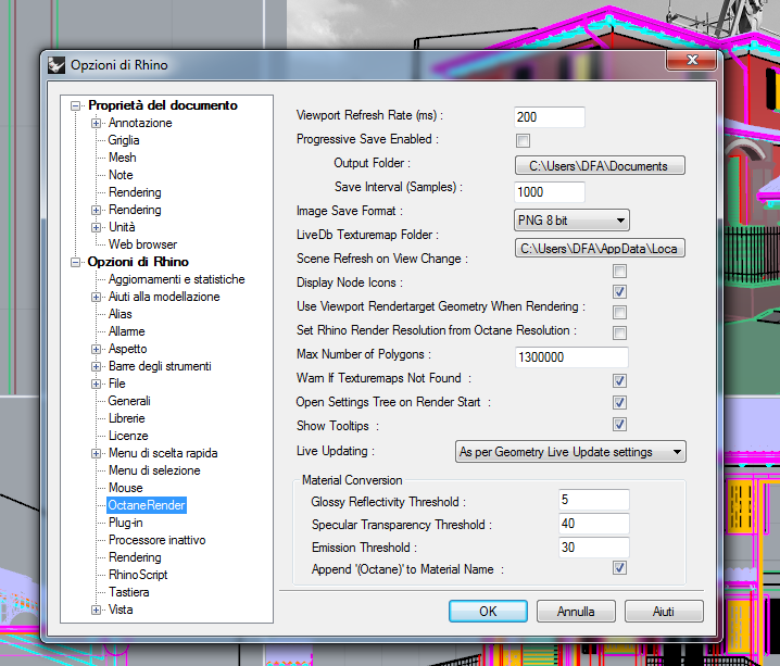

Hi - your system has 8GB of RAM - is that correct? If this is the case, that is probably insufficient to load that scene. The "Out of memory (System RAM)" means the plugin could not allocate a memory block big enough to load the number of polygons you have set in the "Max Number of Polygons" setting. In some cases you can get around this by ticking Live Geometry Update on the large mesh items in the scene, but really - you need more RAM.

first of all, thank you.
No my sistem have 4gb of ram, but I do not think this is the problem, I'm sorry.

The rest of the Cuda mistakes, why are there?

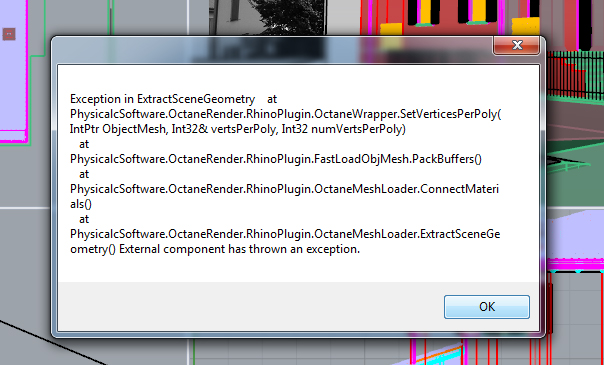

i try this:
Export obj of the scene into octane standalone and work perfect...so maybe the problem is plugin?

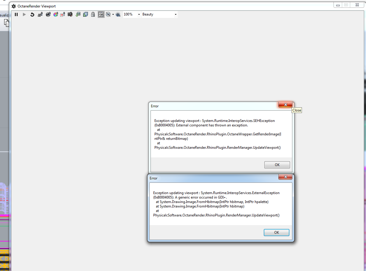

this another error when rendering in rhino...
4GB is definitely not enough RAM. You will get all sorts of errors, because Rhino, the plugin and Octane will all be running out of RAM if you have a sizeable Rhino file.

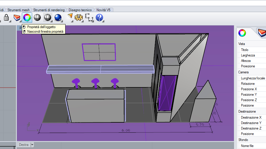

similar problem with a poor file .. when, during render, i change view,Rhino crash.
Can you send me the file pls, and I will take a look.

I do not know why, but now no longer crash when I change views.
I'm pretty sure the VGA Quadro that i use for video management, and GeForce gtx to render, that the drivers conflict ... I do not know whether it is good thing to mix Quadro and GeForce
