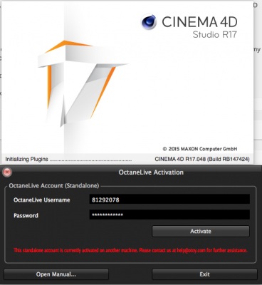

Hello all,
I'm also having problems and getting nowhere by emailing [email protected] - please help!
Using a Mac, I installed the demo, enjoyed using it and then decided to purchase yesterday. So now I'm running V3 Standalone (which logs me in just fine, and works), and the C4D plugin.
My problems start when I open C4D, and I get the login box which looks like the attached. So I input my OTOY username which doesn't work (I'm sure that's ok though) and also my OctaneLive Username and Password. Both for the standalone and the C4D plugin, neither of which work.
It simply says "This standalone account is currently activated on another machine. Please contact us at [email protected] for further assistance".
So I'm confused with the "Activated / Deactivated" status. I have no idea why it doesn't work and I've spent the last day trying to fix this. I've also attached my status (with my credentials blurred out) so you can see what's happening.
Does anybody know how I can fix this?
