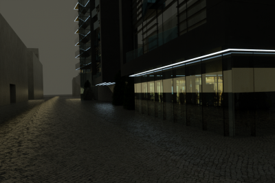

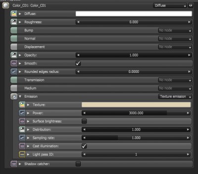

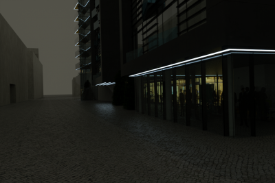

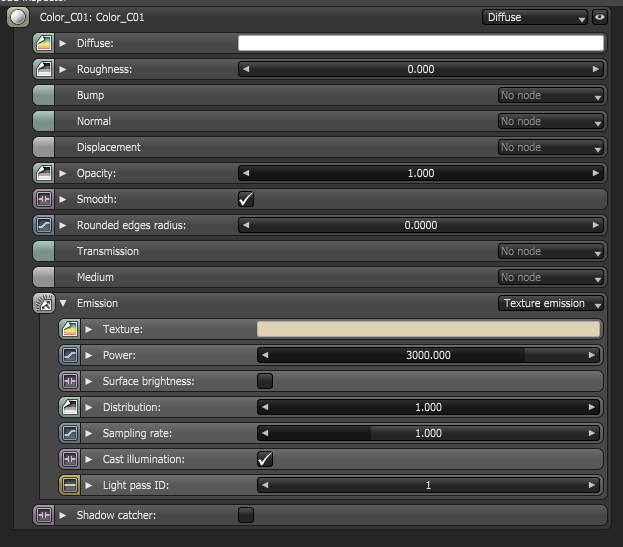

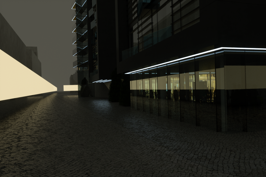

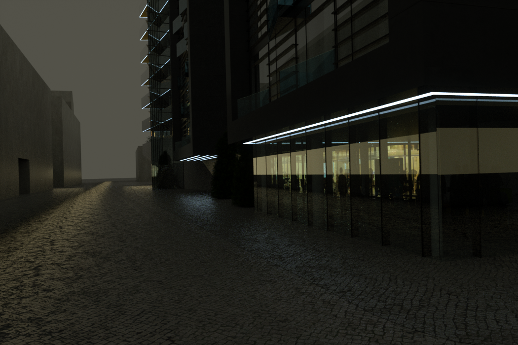

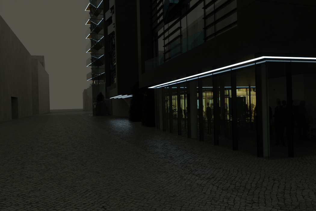

I made a test. and it doesn't work for me ... or I'm doing something wrong...
sampling rate is 1.
test1 - emitter visible - opacity 1
test2 - invisible emitter by Camera visibility unchecked - light on but emitter visible in reflection of glass!
test3 - invisible emitter and no light - camera visibility unchecked or checked , and opacity to 0

ssokol wrote:I made a test. and it doesn't work for me ... or I'm doing something wrong...
sampling rate is 1.
I can't spot any obvious mistake on your side. Could you send us the scenes please?

I had a look at your scene and the light is too dark and the sampling rate too low causing the emitter being. And filtering out those rare samples with the hotpixel filter doesn't help either...
To make it work in your scene (with a black environment): Set the power of the emitter to 5 and enable "surface brightness" (i.e. the total emitted power will be scaled with surface area) and bump up the sampling rate to something like 100 or so, since this emitter will be contributing most of light on the streets. Also don't forget bump up the exposure to 5 or 10 (since it's usually pretty dark at night ;) ).
Thanks abstrax, I will check.
Scene was dark, because it is just beggining and for purpose of tests.
