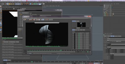

arleksey wrote:i think that the bad place is 90-91 frames, where geometry was collapsed and start to rotate
It crashes also after on 82-83. I have exported the scene as ORBX format to investigate more.
crashed-scene1.rar
(6.01 MiB) Downloaded 185 times

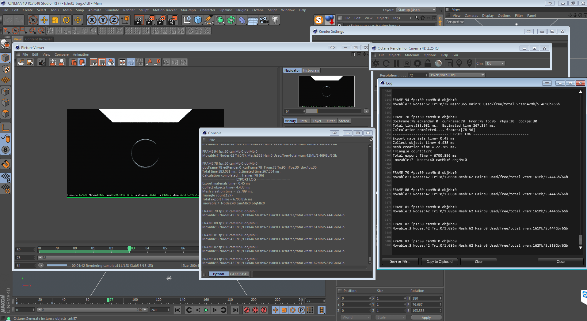

I think i did a mistake to use V3 on. This crashes occurs on V3 not 2.25. Sorry for that.
There a test on Picture Viewer. That's going fine without any crashes.

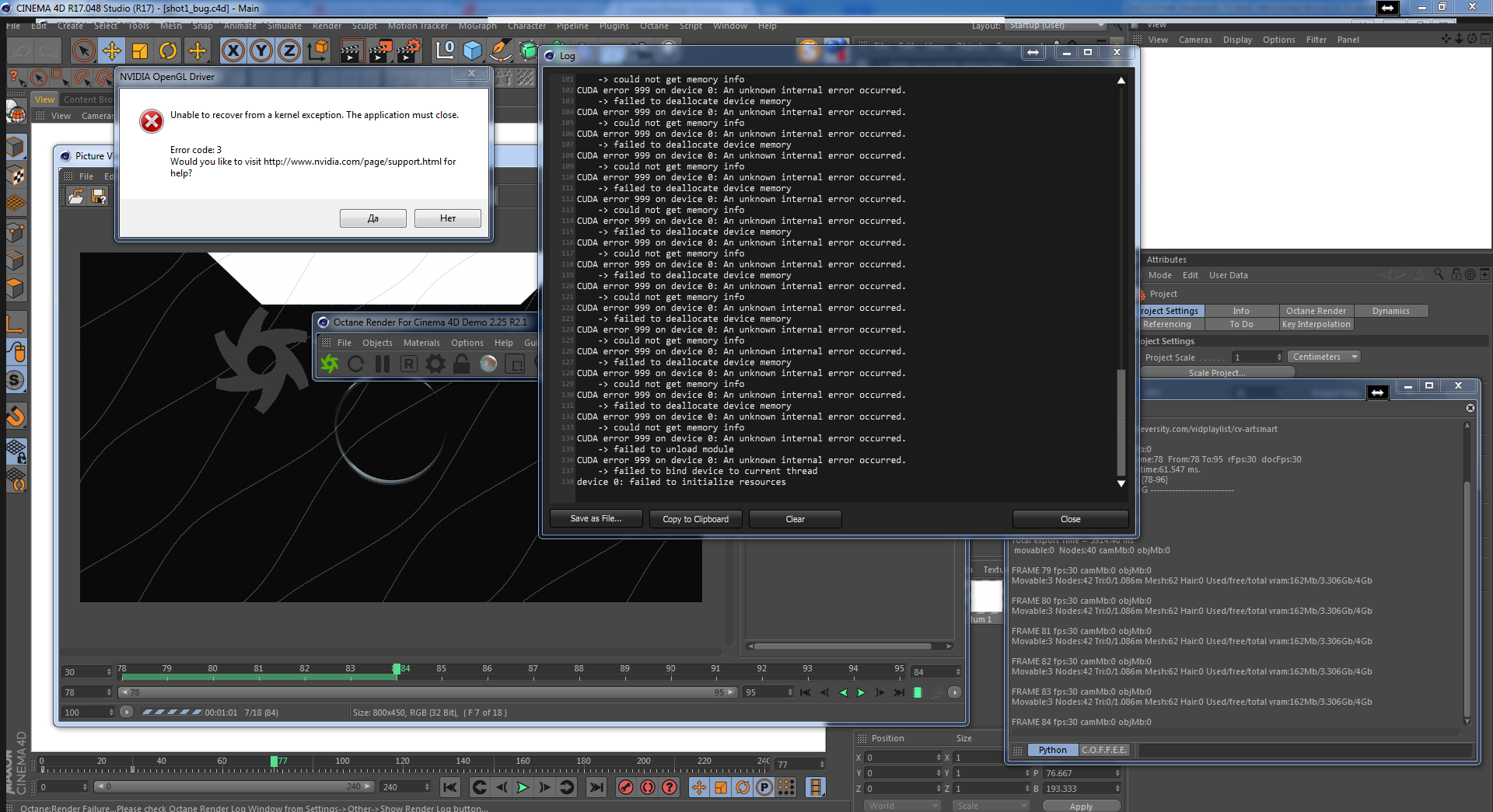

what card and driver do you have installed? or maybe you`ve tweaked something?
couse i couldn`t render this scene in 980 and 980ti with driver`s version 353.62
Posts: 16068
Location: Türkiye
361.43 on 2x780
That's interesting really. Let's check it on V3. We'll see. Can you post what you see in Console and Octane Log window?

this file crushes on 83rd frame on r2.1 and make R3 stops on the same frame
do i need to provide some additional tests or info?
shot1_bug_for_check.zip
(120.38 KiB) Downloaded 188 times
