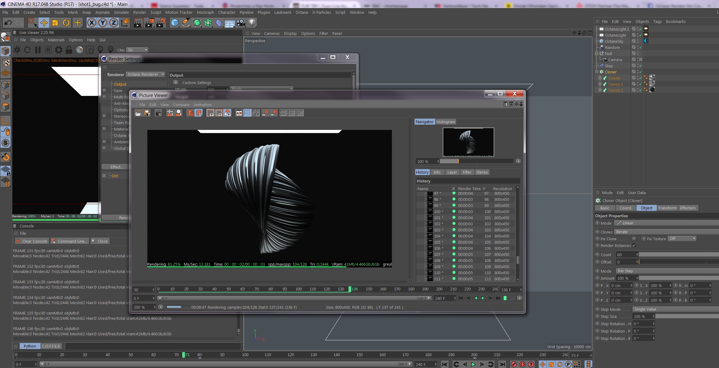

it`s very strange aoktar, but very interesting result.aoktar wrote:I think i did a mistake to use V3 on. This crashes occurs on V3 not 2.25. Sorry for that.
There a test on Picture Viewer. That's going fine without any crashes.
