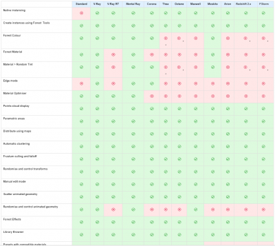

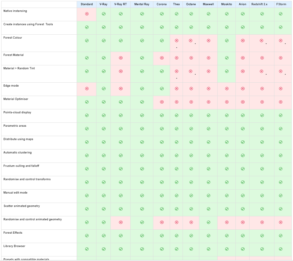

but I agree that Octane needs beter support for ITOO plugins, here is list of supported features in FPP, Moskito render and Vray RT gpu have support for Forest colour.

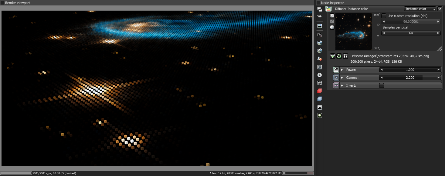

User defined instance IDs 3.07 SDSK
We added the possiblity for plugins (or Lua scripts) to explicitly define instance IDs in all geometry nodes except the volume node. This alone isn't terribly useful, but combined with two new textures plugins can now explicitly define colours for instances. In this simple example, a Lua script graph creates a grid of instances of some input geometry (a cube) and assigns them an instance ID that matches the image used in the instance colour texture.
