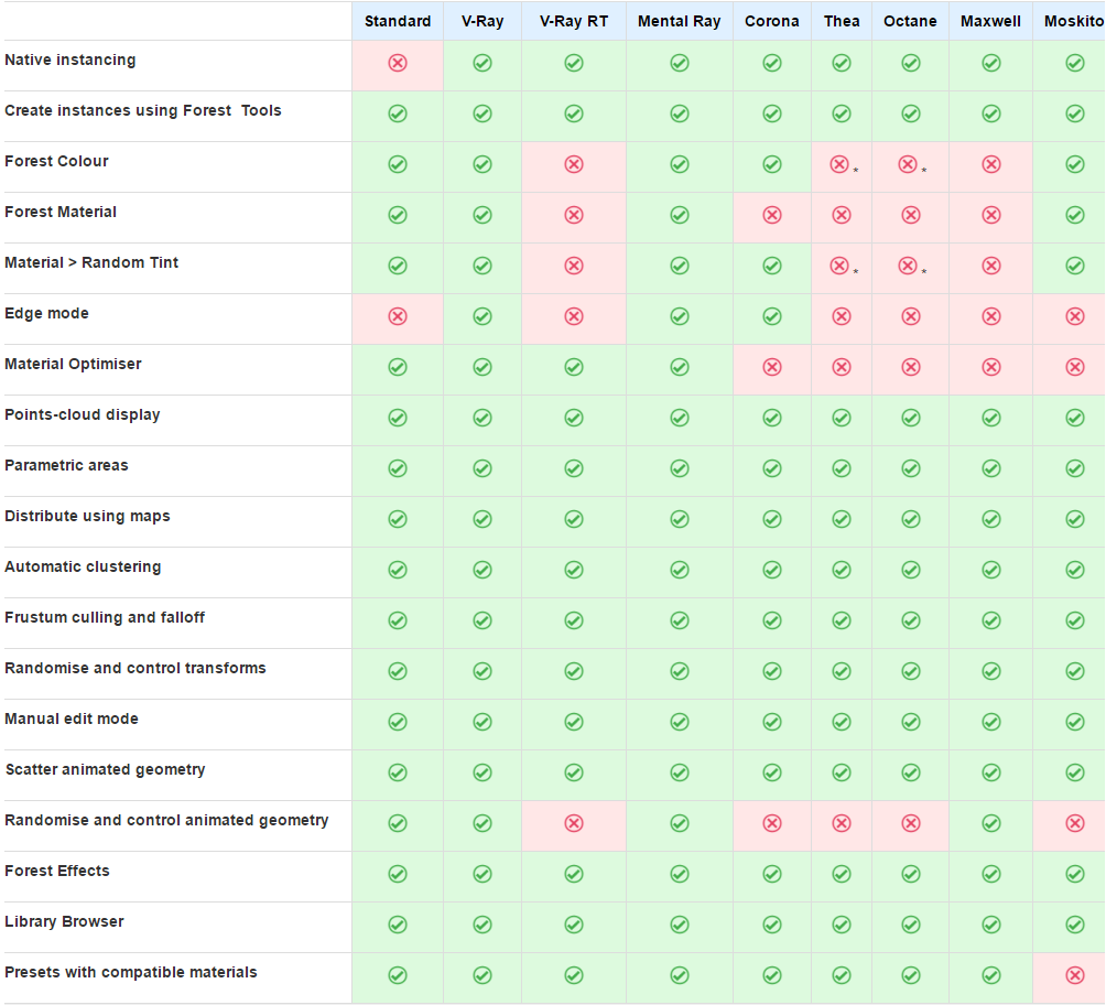

Octane for max v3 is here for some time now, do you have some news about Forest pack pro, as you can see from Itoosoft website Moskito render has support for Forest Colour, Forest Material and Material > Random Tint, as far as I know Moskito render is GPU only render, please add support to missing features in Octane render.

I can see in new version of Vray GPU 3.5 they added support for ForestColor map.
Quote form Chaos group website:
https://labs.chaosgroup.com/index.php/r ... r-3ds-max/
"ForestColor map support for Forest Pack:
We have been working closely with iToo Software to more directly support ForestColor texture from Forest Pack in the GPU code. This feature will allow users to better take advantage of the color variations provided by the ForestColor map. This feature is now supported by V-Ray GPU as well."
I`m waiting answer from Otoy on this. :roll:
