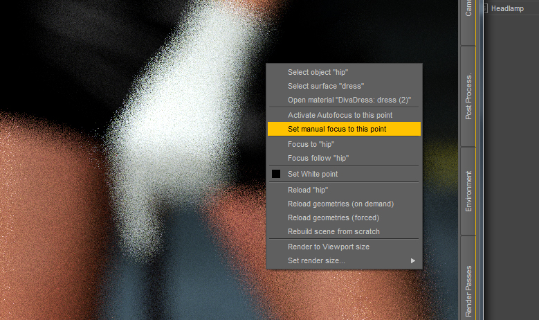

[Test] - Bugs Reports.
(Infos : Using DazStudio 4.8 Official (not the 4.9 beta))
- Problem to set manualy a focus to a point (the hand in the exemple)
- Sometime, i have to rebuild the scene or he do not restart the render
I will continue to test this new version.
Ye - it looks like Focus Picking is not working at the moment. This appears to be related to when you export a scene to ORBX, the Octane camera focal distance, etc is not set correctly in the ORBX. I am working on it - but it will take some time to fix.
