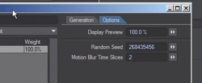

Yes, you are right, there are some problems with the instancing motion blur in the OSX version, I think that related to a bug in the LightWave SDK.
The good news are that I have found an easy workaround: it seems that if you set the "Motion Blur Time Slices" parameter to 2 in the instancer options panel all works fine. Can you please test this workaround in your scene?
-Juanjo
-Juanjo

Yes, that's great. That totally fixed it. Thanks again!
