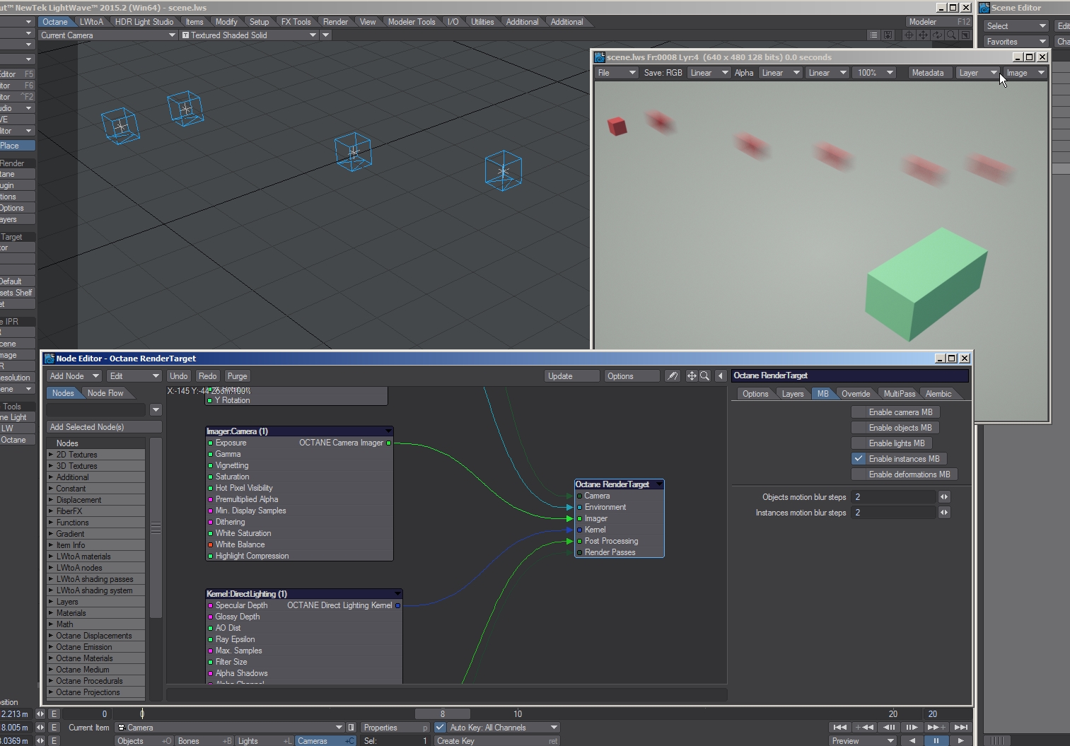

Really it is hard to understand the problems that you have without the scene, but I can confirm the the motion blur can be enabled in the LW instances over null objects while all the MB of the other objects and the camera is disabled. Attached you have a sample scene and a screen grab ... the "ship" object (the green cube) is moving without motion blur, while the "box" object (the red cubes) are native LW instances over null objects that have MB because they are instances.
You should be able to scale from 0 to 1 in one frame the null instances without problems ... perhaps you should scale the nulls to 0,0001 to avoid problems.
Also remember that the instances motion blur is rendered only in the final F9/F10 images. The IPR doesn't support instances motion blur due a limitation in the LW SDK.
-Juanjo
