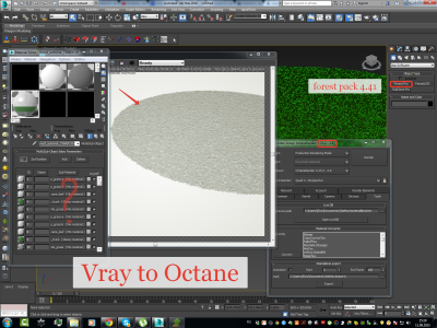

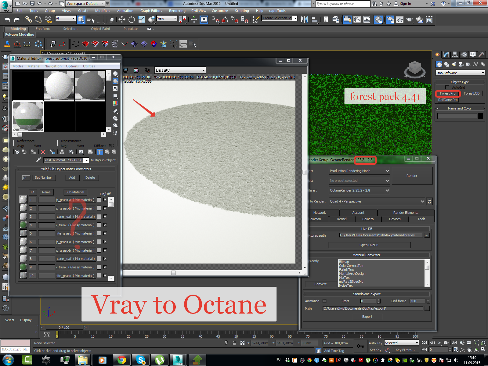

Converter does not work
Vray, Mental ray gives all white
3ds max 14-16, forest pack 4.4.1, octane 2.23.-2.8
Hey Elvis,
That is because a texture named ForestColor is not supported.
It is Forest Pack's own texture.
That has to be implemented in Octane no arguments there.
