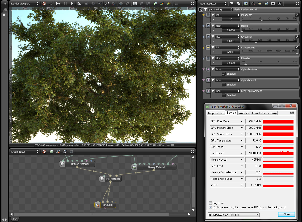

2.4 pre-beta speed improvement on 460 gtx
1 x GTX 460 2GB, Core i3 @ 3,7Ghz, 4GB Ram, Win 7 64-bit, 260.99 WHQL
Here's what I was talking about:). Alpha shadows on vs off = 1.2 mega samples vs 1.64 mega samples.

Ok then.abstrax wrote:Unfortunately, there is more to speed than only the number of cores. All these additional cores are only of any help, if you can utilitze them, i.e. the code runs fully parallel. How parallel things can be executed, depends on the geometry, materials and kernel settings and other stuff. -> An increase of 50% render speed is not possible and won't happen.
Also make sure that you disable alpha shadows if you want to compare render speed.
Cheers,
Marcus
