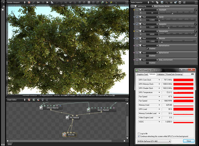

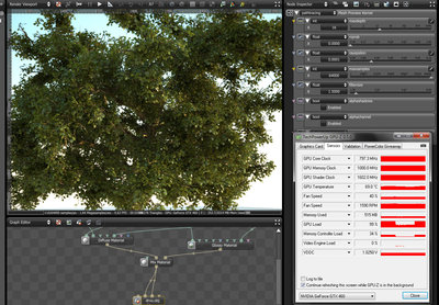

Here's what I was talking about:). Alpha shadows on vs off = 1.2 mega samples vs 1.64 mega samples.

abstrax wrote:Unfortunately, there is more to speed than only the number of cores. All these additional cores are only of any help, if you can utilitze them, i.e. the code runs fully parallel. How parallel things can be executed, depends on the geometry, materials and kernel settings and other stuff. -> An increase of 50% render speed is not possible and won't happen.
Also make sure that you disable alpha shadows if you want to compare render speed.

I have done a test using GPU-Z v0.5 on my GTX460 1GB card using a render file on both this and the previous release.It's definately using all the cores to render up with.GPU-Z is reporting 95-98% usage of the GPU.So all the cores are in play.As i commented in another thread and correctly guessed earlier in this thread, the earlier release was incorrectly reporting only 2/3rds of the cores in play where'as actually it was actually using all the cores to render with.Hence why there is now only a 10-20% increase in speed on this release over the previous one as this is probably down to just the code optimisation only.
