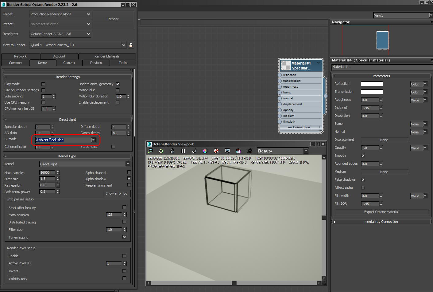

This version of 3ds Max plugin (using 2.23.2 engine). GI mode: Ambient Occlusion.

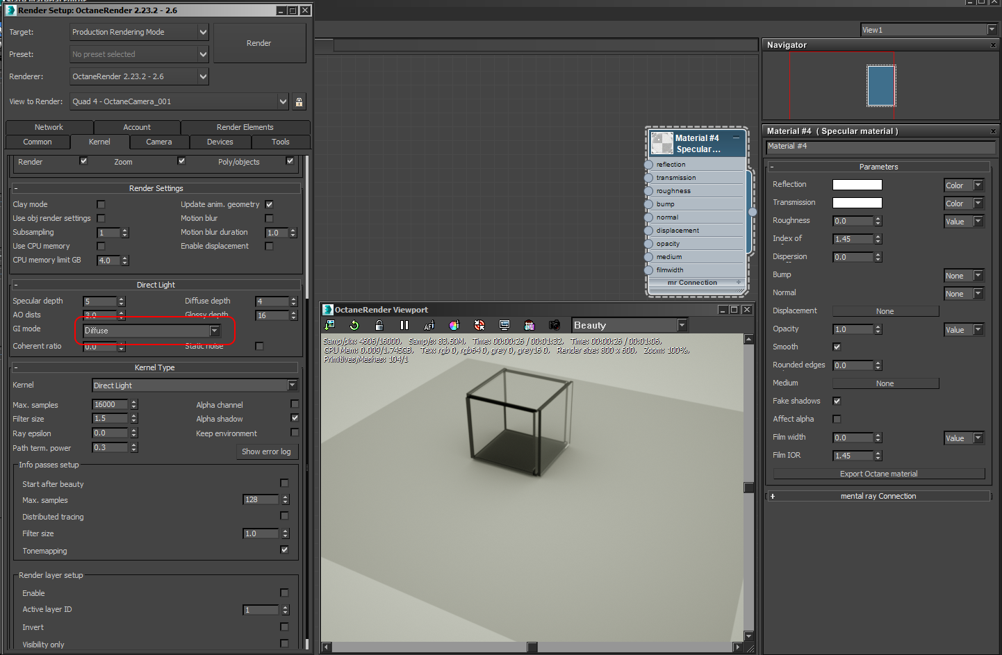

This version of 3ds Max plugin (using 2.23.2 engine). GI mode: Diffuse.
Standalone 2.23.2. GI mode: Ambient Occlusion.
Standalone 2.23.2. GI mode: Diffuse.
