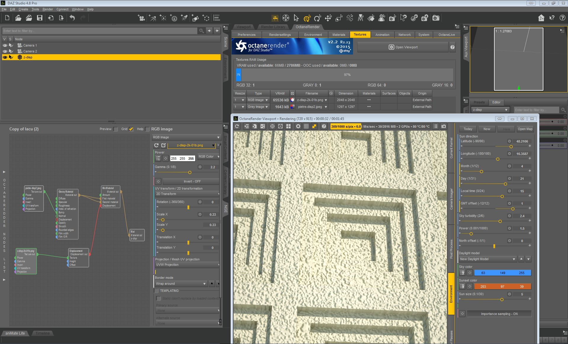

aoktar, the c4dOctane plugin developer, has found a very useful trick on how to use bump or normal maps together with displacement:
http://render.otoy.com/forum/viewtopic.php?f=87&t=48024
The trick is to connect twice a material with bump or normal to the two materials slots in a mix material and use the separated pin of the mix material for connecting the displacement. and obviously works also with DAZ ;)
happy rendering
ciao beppe

bepeg4d wrote:Hi,
happy rendering
ciao beppe
that is clever.

Just tried that displacement+bump workaround, and it worked splendidly!
Thank you soooo much Beppe for posting about it here!

That trick worked well with the somewhat complicated auto-generated (but of course modified) mixed material for Michael 6 HD's skin.
I did reduce the displacement settings somewhat from 0.3 and -0.15 to 0.2 and -0.1 and added some HD-detail from the Boris, Aging, and Veins sets (at SubDiv 3).
Oh, and the beard is by Laticis Imagery:
http://laticis.deviantart.com/art/Latic ... -521807046
Here's the result:
