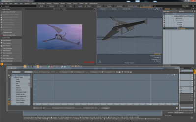

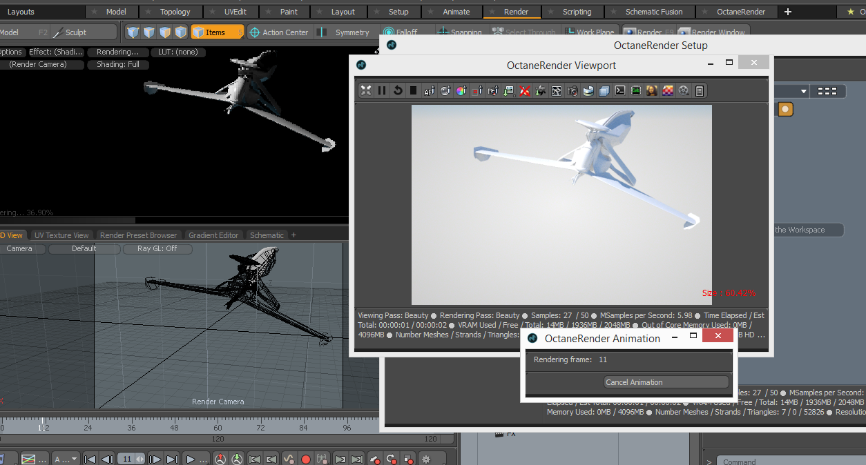

I can get cubes to work in a fresh scene, but If i try the same cubes setup in my existing scene it doesn't work.
By "not working" I mean objects are animating in modo viewport but not in octane render viewport.

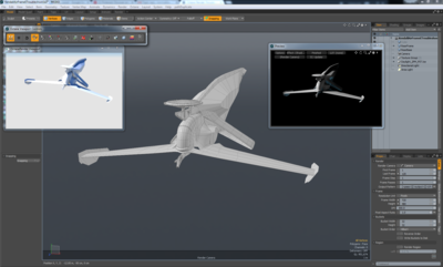

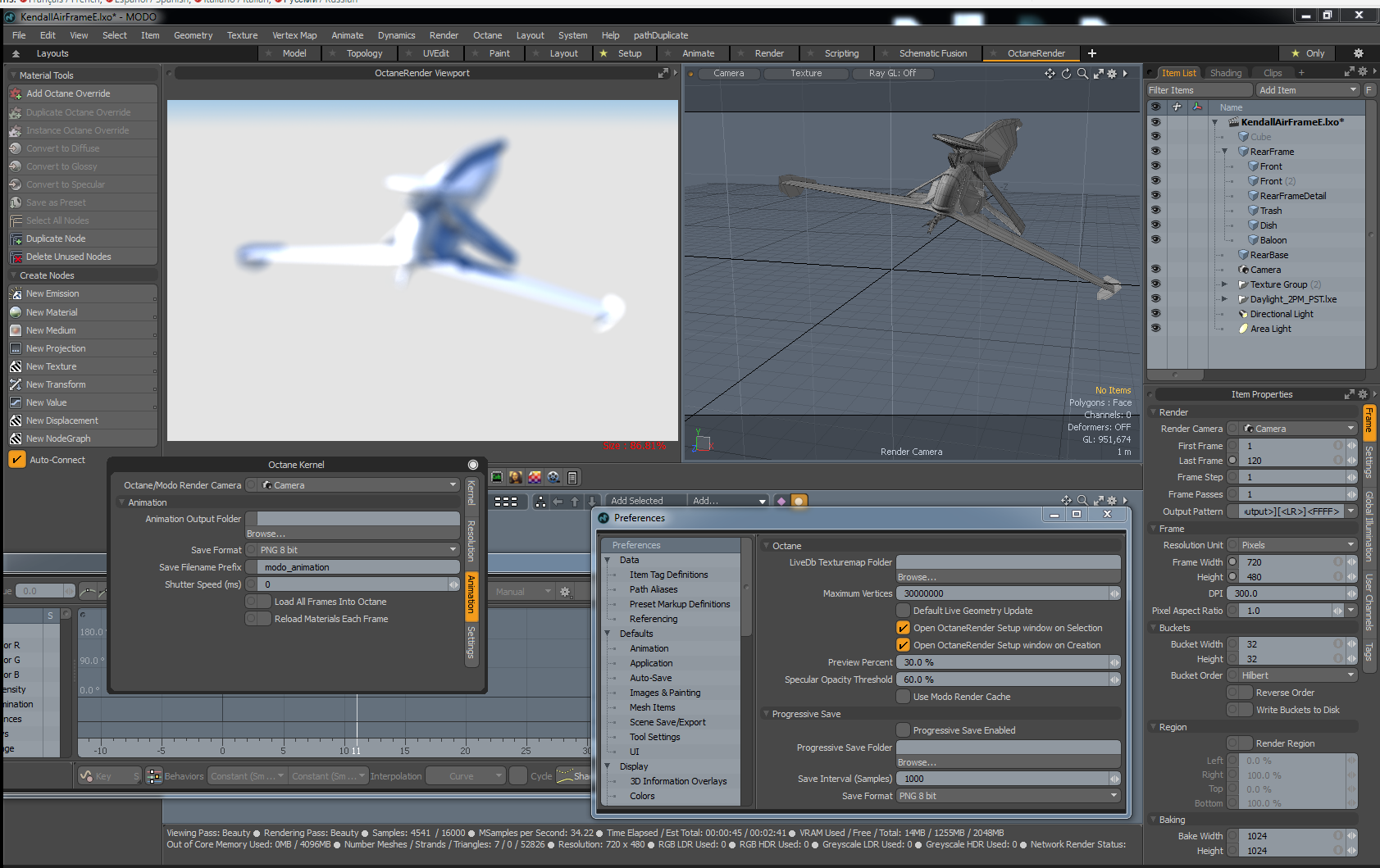

Here it is again on a simplified version. No instances in this one, just plain old meshes, parented to another mesh. all have live geo on. other settings pictured. Here's the scene file. https://mega.co.nz/#!j8Vm2DzK!WUp4YLcXF ... sYc-ZPkn14

I'm really sorry, but when I render this to an animation it looks fine to me and I can't see from your screenshot any issues. Have you tried on Modo801? Perhaps we have slightly different builds of Modo901.

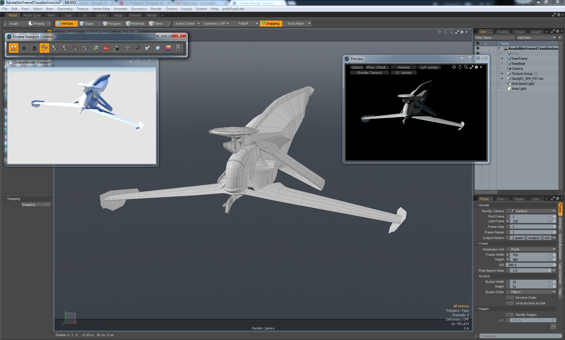

Hmm..I was on 901 beta for a bit but did a complete uninstall-install.
Here it is on 801 SP4
Maybe it's a script...I'll try a clean install.

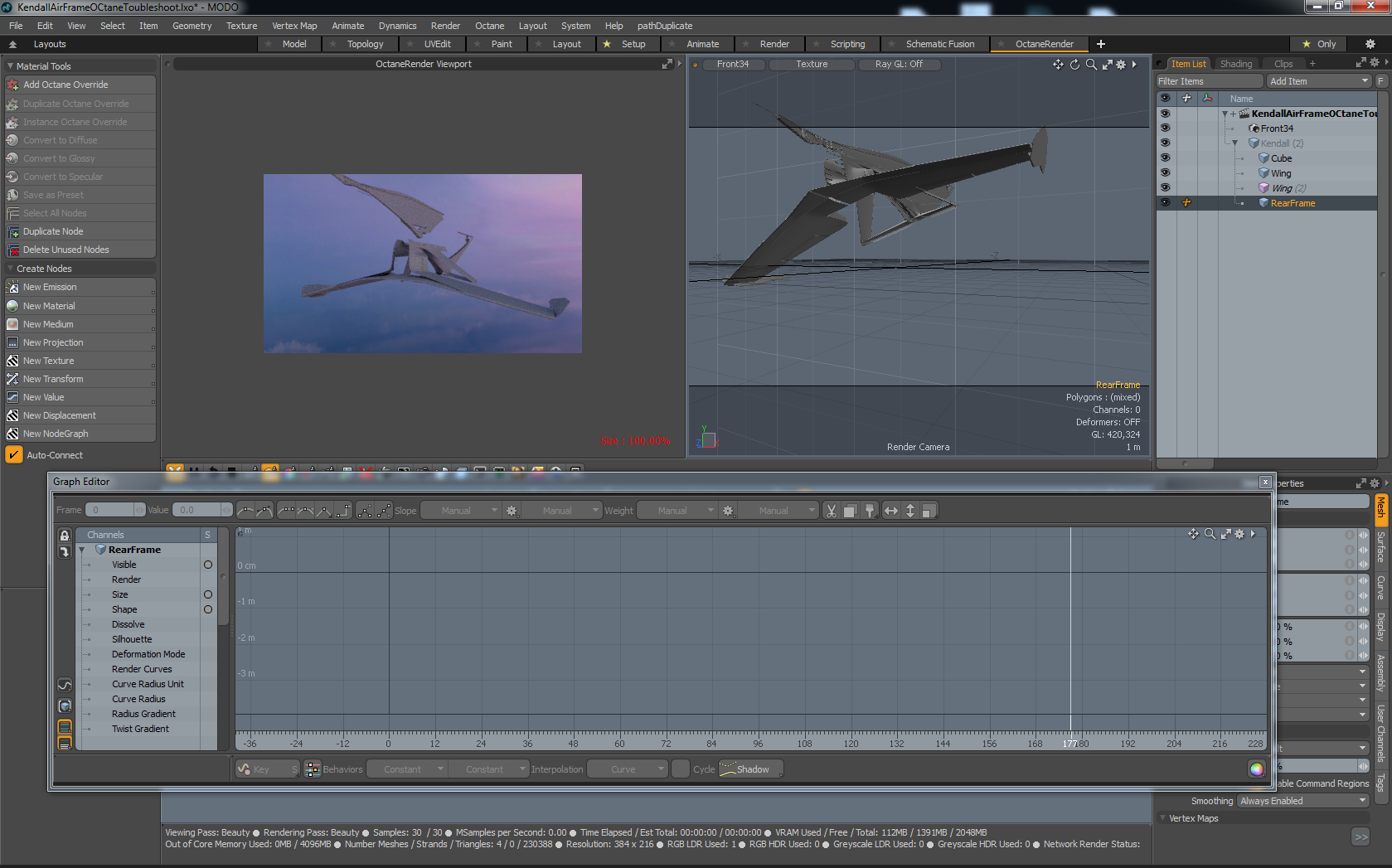

Ok, I just got that test scene to work in 801 with "Load All Frames Into Octane" Checked ON with 30ms blur. Gonna check with the big scene now..
AAAAnd its working!!!! My configs path was messed up, fixed that and now it sorta works so that's my best guess. Yay!

Not sure if it helps - but I am seeming problems with Mesh items with Live Geometry update ENABLED not animating in Modo901 if Use Modo Render Cache is ENABLED. I am trying to determine if it's a plugin glitch or a Modo901 issue.
