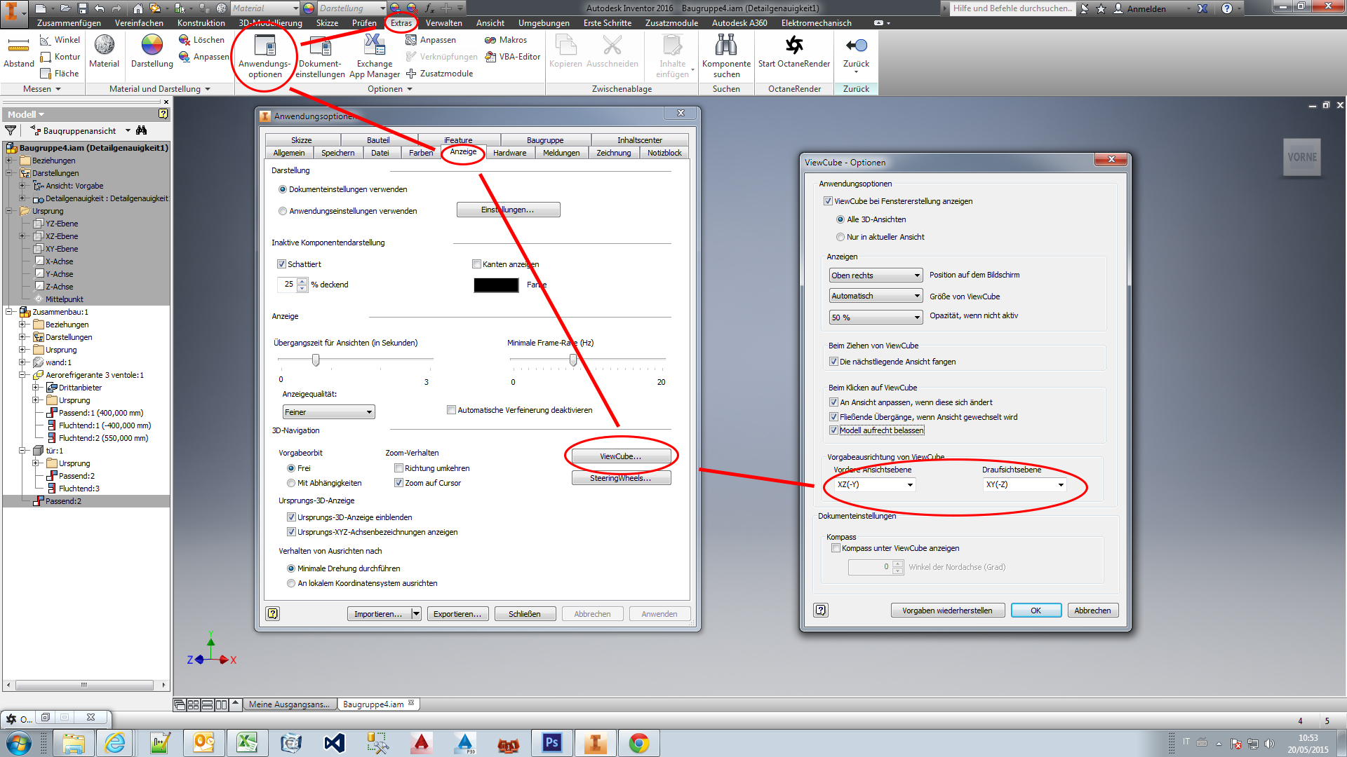

BUT... i found something that might explain it.. there is a new setting i am not really sure when it has been added. bust have been within the last few years, and this setting is different based on the Language/country of the installed package.
attached is a screenshot.
Maybe you can read this value and adjust the view accordingly?
see the screenshot... since my inventor is german i marked where to click.. :)
I can't see a way to read these values from the Inventor API - it is providing the camera transform in Y=Up coordinate space, so there is another transform internal to Inventor which converts the axis. I think a configuration checkbox to switch axes is the easiest option.
