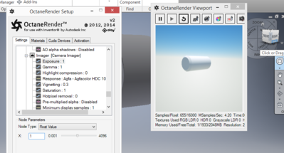

Hello! Dont know if this is a bug, or if i am too stupid, or if tis just supposed to be like that and I get it wrong...
When I open the scene and import all the components, the sky appears tilted 90 Degrees. so if i am standing in front of my Object, i will have the left side of the sky White, the right side blue, and in between it is fading from White to blue. Can this somehow be controlled/rotated?
When i position the sun where i would like it to be, it happens that the sun goes out, like on eavening. problem is that wne it happens its on the zenit..
In inventor my "up" axis is Z.
ps: gonna fill this inventor forum up if I keep going this way.. :D :oops: :oops: :oops:

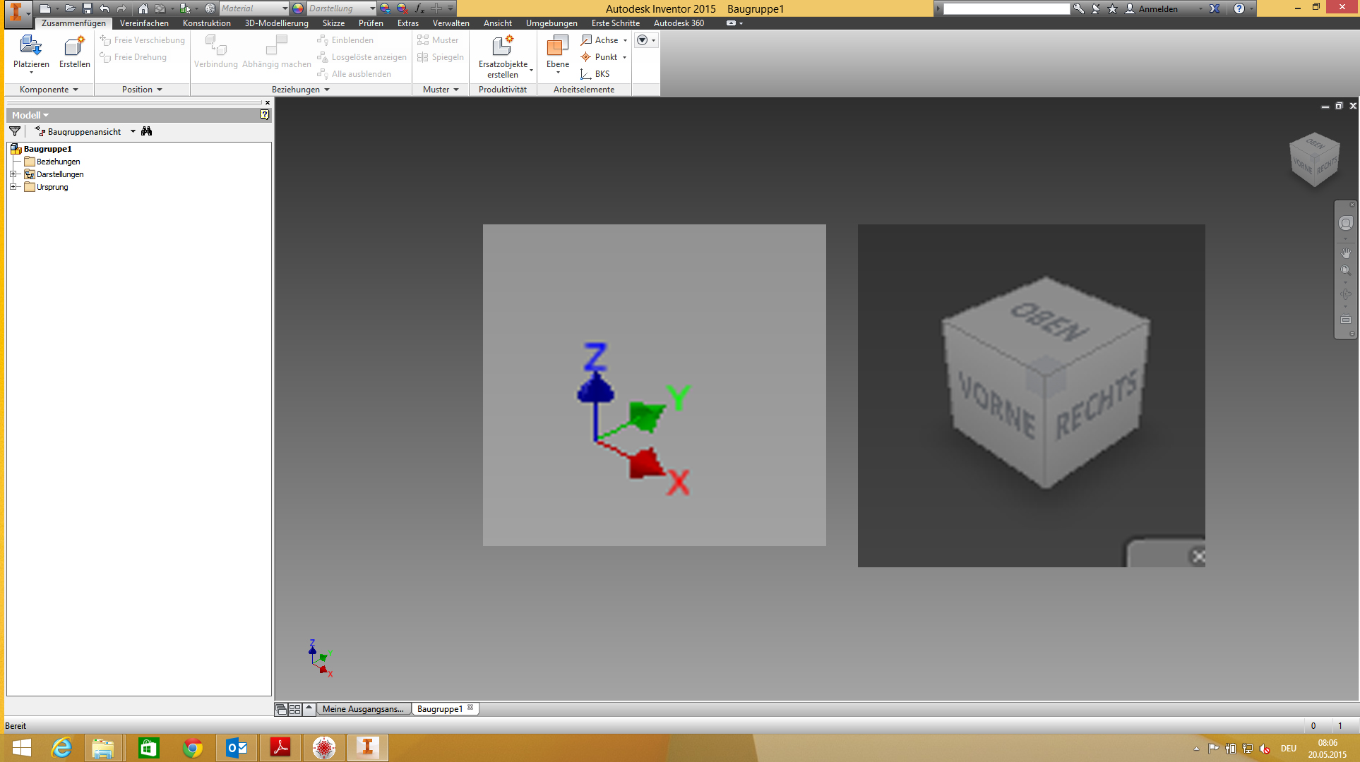

Hello!
I've installed Inventor 2016 a few days ago, and tested IV2015 on another pc, Z is Always pointing up, and as far as I can remember it has Always been like that..
attached is a screenshot of a fresh, new, untouched file from the template..
Vorne = front
oben = top
rechts = right.
it either is a wrong setting on your end, or a different setting based on country culture.
Have you ever modified your template file? because the base coordinates are defined in there.
