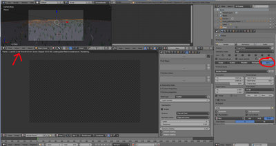

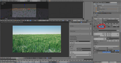

thank, but i have set the plane as "Scatter". (picture "render-panel-Scatter")
It work very fine if set scatter in render panel, only 1-2 min. to transfering :-), but when i use more object with other setting in Octane properties, dont work...
If set to "As is" in render panel, and Scatter to Plane Objekt in Octane properties, I waiting up to 10 min. only Transfering. (Picture "render panel Scatter")
best regards
Stefan
Scatter only work when setting "Scatter" in render panel
Scatter dont work with setting "As is" in render panel

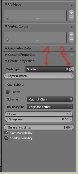

hi planung-klein ,
try to help. the "grass" object (the dupli object in your particle system) must be a "mesh type" scatter. Not only the plane.
A. select all the mesh grass (grass_bahiagrass ?)
B. change mesh type from "global" to "scatter" (view attachment, operation 1 + 2)
C. select the plane and add particle system
Ciao, SimDal ;)

simdal wrote:hi planung-klein ,
the object to be repeated is of scatter?
Hi SimDal,
YOU ARE THE BEST :-)
I havent setting Scatter to the Gras-Mesh, fantastic work fine :D :D :D
