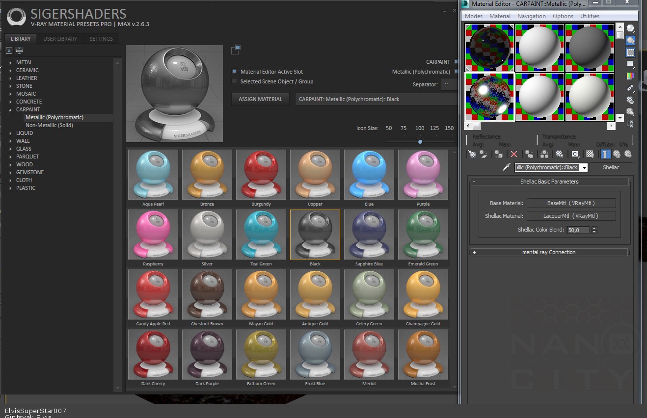

Converter not work correctly. The leaves of the tree became specular
and does not understand shader Shellac
