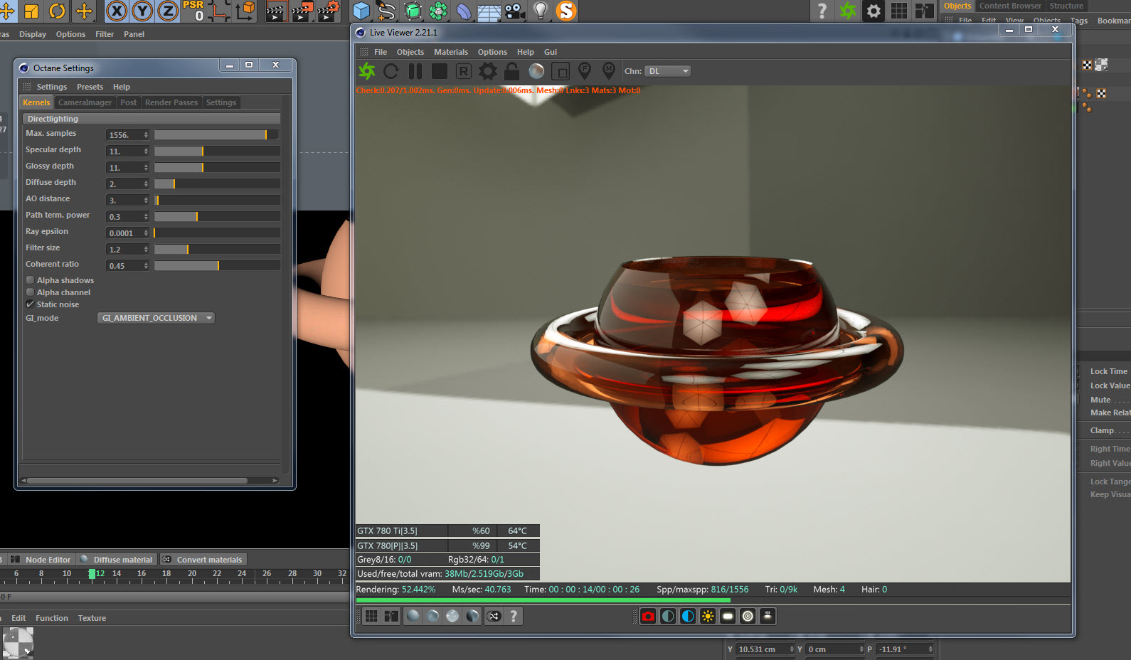

Next step check my test scene. It's very well with some tweaks on kernel and material. Notify i have to use "coherent ratio" + "static noise" to decrease the noises. It's ok with 256-512 samples on DL or PT. Btw, not a good idea to try the removing the noises in ae.

Ray epsilon changes a lot, the noise disappears in the reflections of the hydra image, the bottle looks completely different but no noise at all ray epsilon 0,011 ...
Are there any rules/thresholds/Frontiers for epsilons values

What's your bottle's dimensions? If your objects are small and scene is not big as a 1km. or more, try lower values. For big ranges of scenes, you may need to increase it. That's a treshold factor for lowest values of ray intersections. Because Octane uses floating point math and this is a limit on ranges of dimensions. Think that as a scaling correction factor.martinzip wrote:Ray epsilon changes a lot, the noise disappears in the reflections of the hydra image, the bottle looks completely different but no noise at all ray epsilon 0,011 ...
