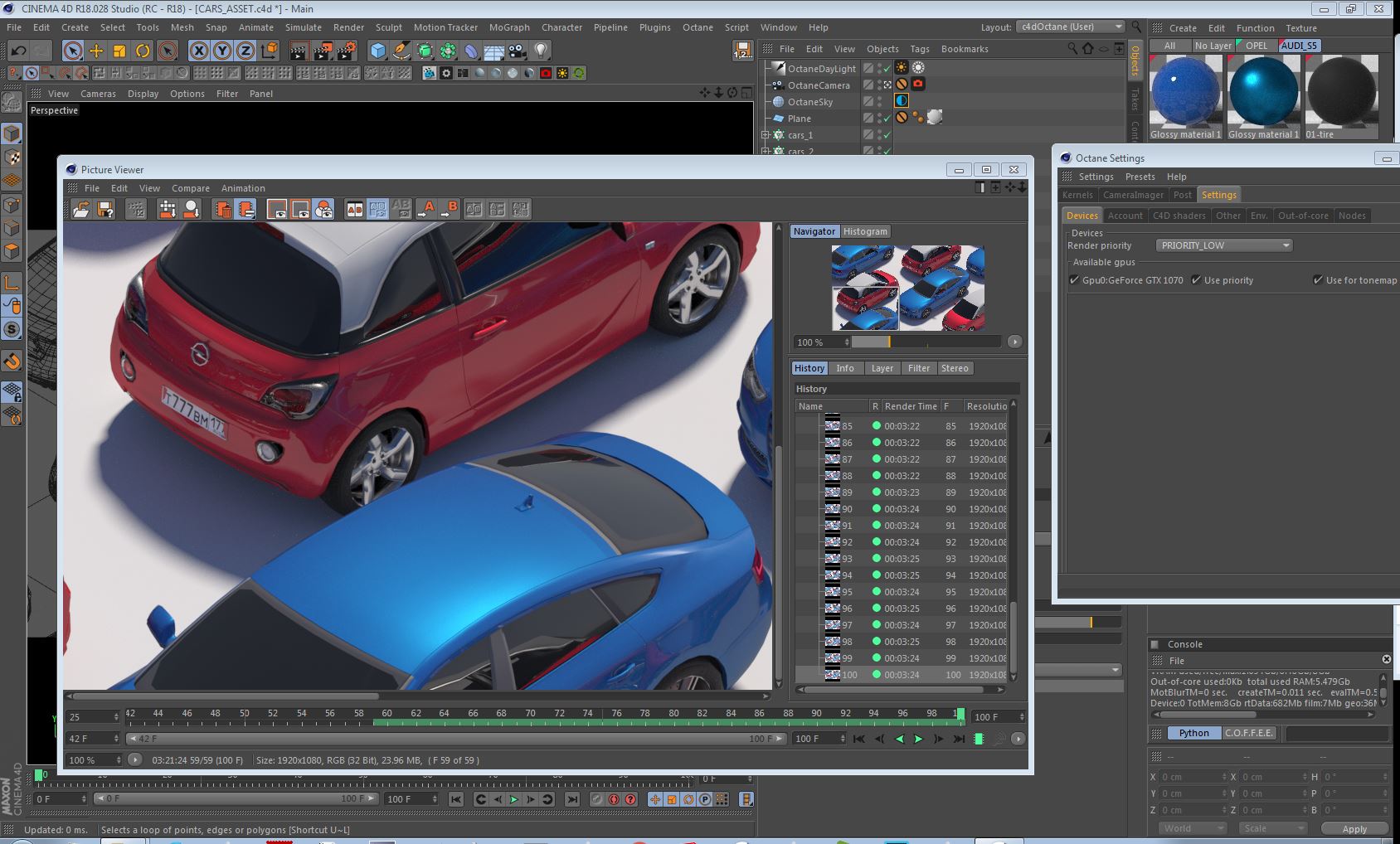

can not confirm.
your scene renders just fine here. rendered 14 frames for the sake of a test.
i am using the latest versions of all: plug-in, standalone and r18.028. win7 pro with nvidia driver 376.33.

Also no problems rendering your scene. Tried 2 frames (42 - 43).
I'm Using Octane 3.05.1, C4D R18.028, 32 GB Mmemory, 3-TitanX (Maxwell), Nvidia Driver 376.33
The scene initially took a few seconds to load.
I also tried reducing your HDR file by 50% and that did load much faster and the render still looked OK to me.

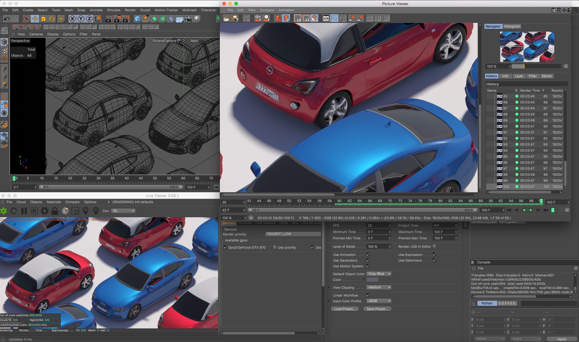

Hi anatolikbelikov,
as other users, I was able to render your entire sequence on both Win 7 with 1070 and Mac with 970 without issues:
Are you sure that your motherboard and CPU are correct for multi GPU?
Maybe it is a specific overheating issue.. have you tried to check with GPU-Z your cards while rendering?
