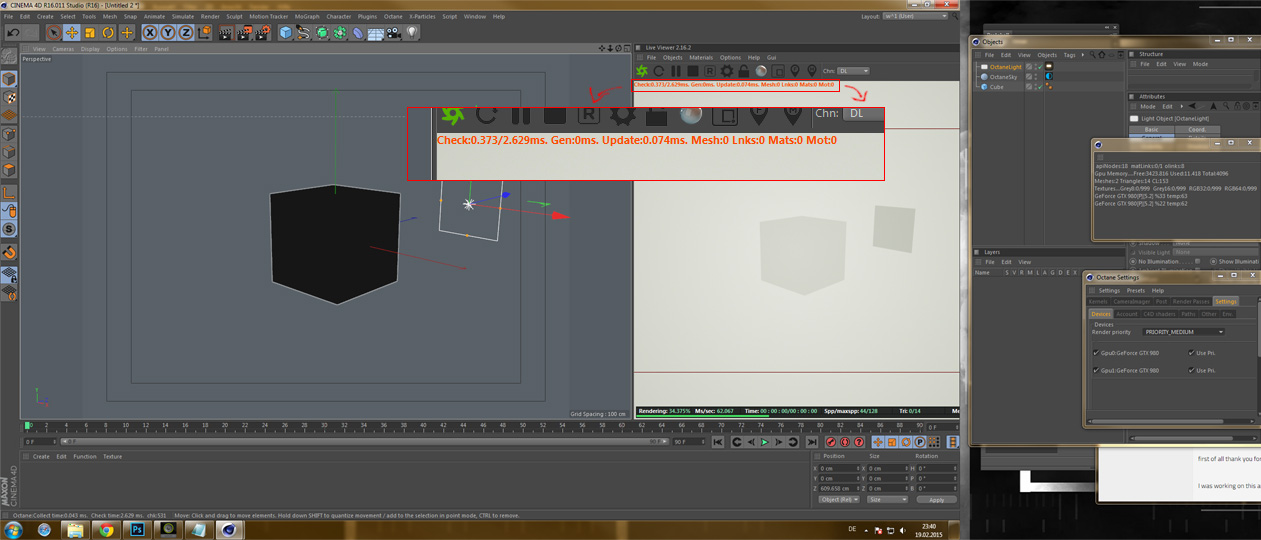

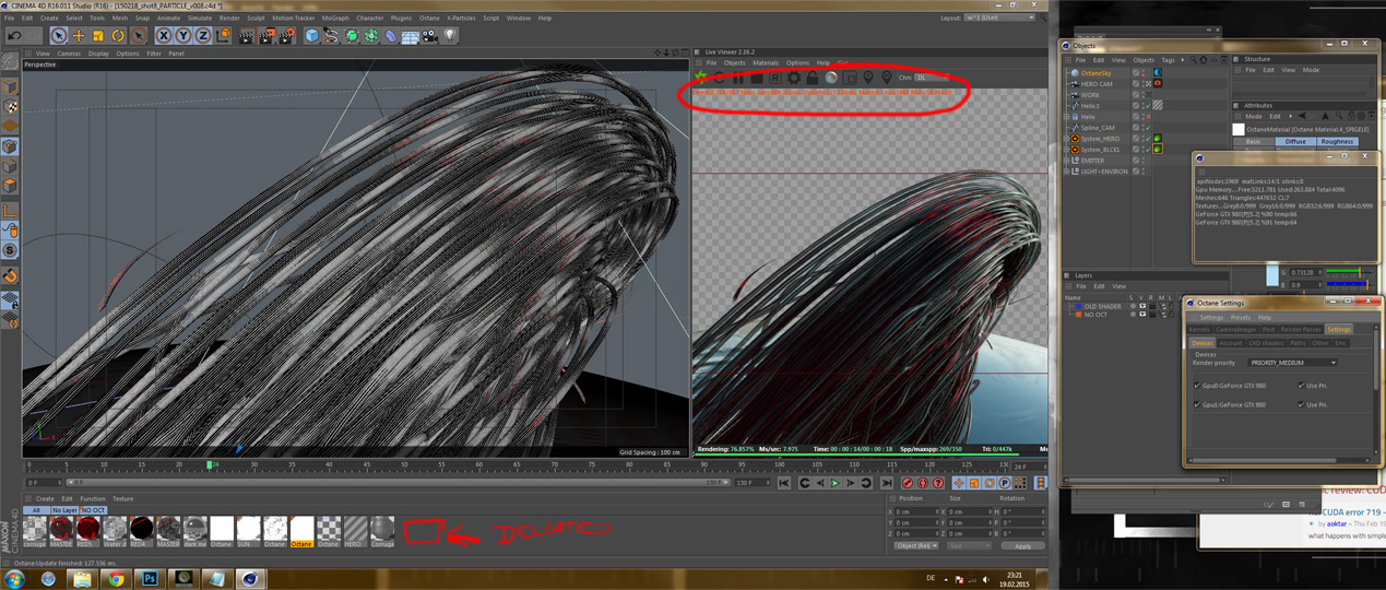

I am getting a "CUDA error 719" after updating the nvidia driver to version - 347.52. The CUDA 719 error is an known issue and I have red a couple of times in the forum about it - unfortunalely nearly every forum topic about the "CUDA error 719" is not solved >>
_My C4D setup (and the C4D octane plugin) worked before updating the nvidia driver
_I have tried to go back with the drivers (to version 347.25 and 347.09), but it still doesn´t work

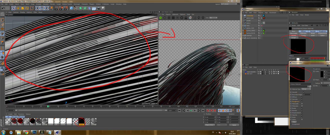

_yes, I am using big textures in that C4d setup - but, before updating it was working and it shouldnt be a problem with two gtx980 cards, though (4GB ram, each)

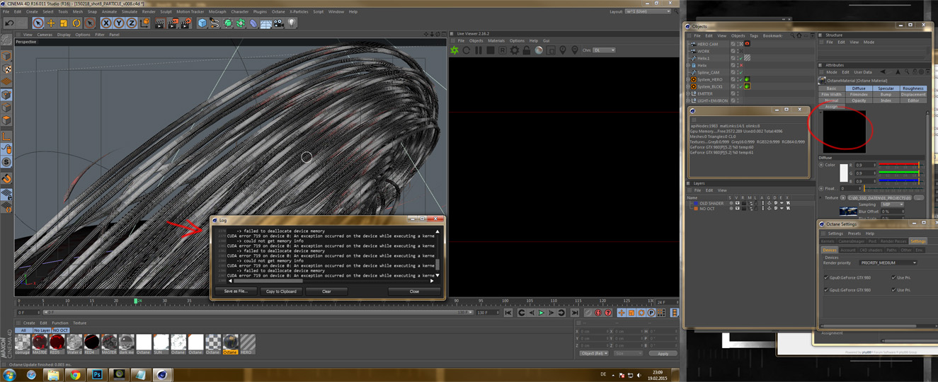

_live viewer shows a black image, the renderer creates a black image.
_I have rebooted and reinstalled the C4D octane plug in
_if I check the textures in the material editor (doesn´t matter how big they are) the material preview within the material editor turns black (the material in the preview window turns also black)
_besides, maybe its good to know that the nvivida openGl driver died a couple of times with an "error code 3" message, before and after updating

--------------------------- EXPORT LOG ---------------------------
Export materials time= 3756.891 ms
Collect objects time= 16.707 ms
Meshes creation time = 305.177 ms
Octane voxelization time = 0 ms
Sending to Octane engine time = 0 ms
CUDA error 719 on device 0: An exception occurred on the device while executing a kernel. The context cannot be used anymore and must be destroyed. All existing device memory allocations from this context are invalid and must be reconstructed.
-> failed to copy 2D array to device
-> failed to deallocate device array
-> could not get memory info
-> failed to allocated device memory
device 0: failed to upload data texture 10 of context 0
<<< Render Failure >>>

Oh, I guess I forgot to describe the images:
1. The image with the black "Live viewer" is the first one. It shows that the CUDA error appears.
2. This image shows the live viewer with performance issues though the 22k texture is deleted. There are no ohter big textures in that scene. Btw. what does it mean, when red text appears within the top of the live viewer while its calculating the image...I guess it communicates that it has performance problems?!
3. This image shows the scene with the 22k texture that appears even in the preveiw boxses black. The live viewer is not updating.

number from left to right:waldemarborth wrote:and here is a screenshot of a very simple file that has a red text within the box as well.
1-checking the scene time in millisecond
2-generating mesh data timer(ms.)
3-Octane Render data updating timer(ms)
4-Total movable mesh count
5-Object link count
6-Material count
7-Motion data count
