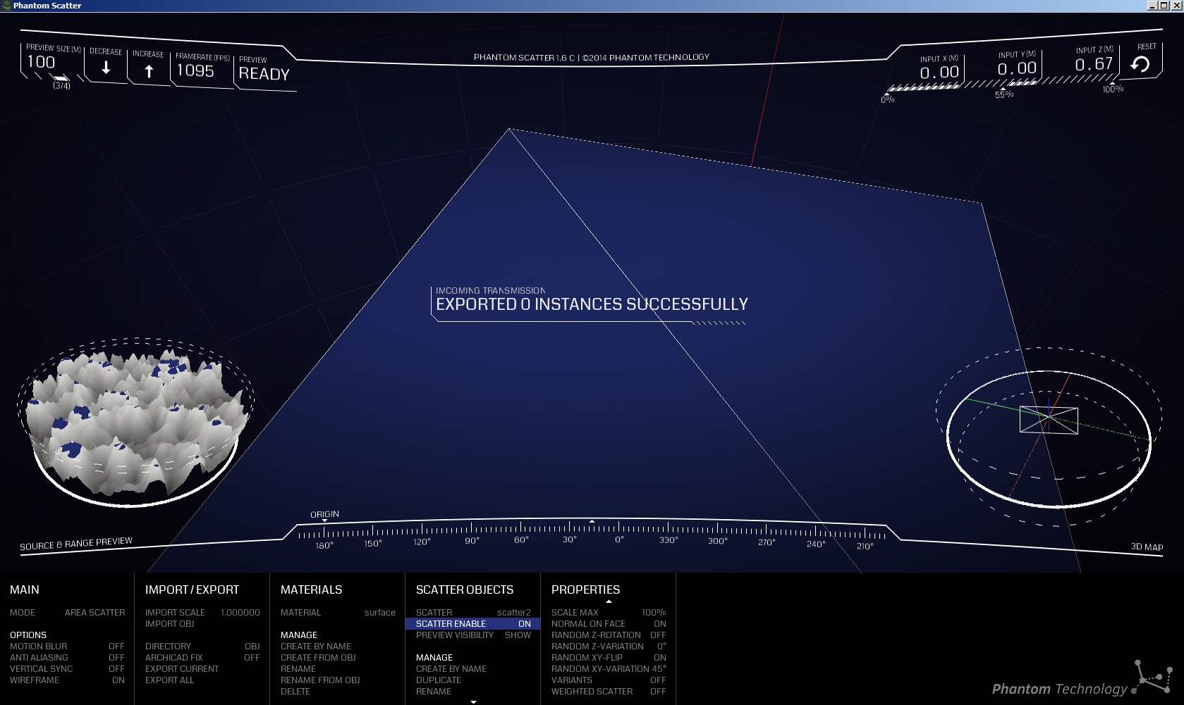

but the obj file attached in my previous post IS in meters BUT Phantom Scatter is not scattering any data on it, it is a solid split in 2 main surfaces were the scattering is to apply to the 'surface' material, it doesn't and it is not the first time that happen despite is just a stupid planePhantom107 wrote:OBJ models you import in Phantom Scatter should be in meters. Exported data in CSV files is always in meters because of that, not need to scale that in Octane.

Notice how in the source & range preview on the bottom-left corner on the screen, only a few bits are highlighted.
Try putting RANGE MIN to 0 and RANGE MAX to 100.

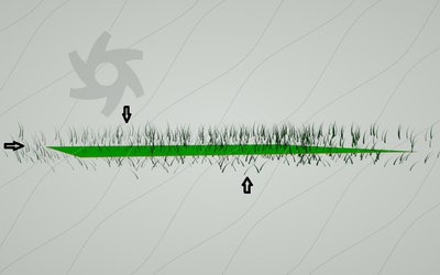

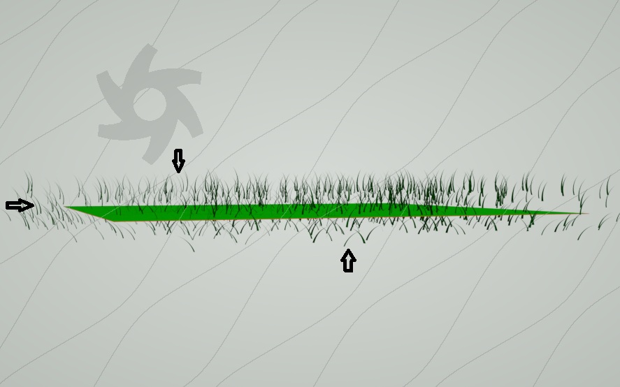

right..getting close to a better understanding AND use of your soft, one thing though, which value control the scattering to actually stay in the scatering area? I have my obj flying over AND spreading OUTSIDe the scattering area that I can see from the previewPhantom107 wrote:Notice how in the source & range preview on the bottom-left corner on the screen, only a few bits are highlighted.

1. Make sure the surface you are importing into Phantom Scatter is NOT double-sided. Phantom Scatter will work with the geometry you give it, so don't give it geometry that you don't want to scatter on. I take it this a Rhino OBJ exporting problem again?
2. My software will never put stuff ouside of the surface of the OBJ you imported. Make sure that the OBJ you are scattering around in Octane (the piece of grass) is placed at the center of the world (0, 0, 0). (as stated in the manual figure 06.1)
