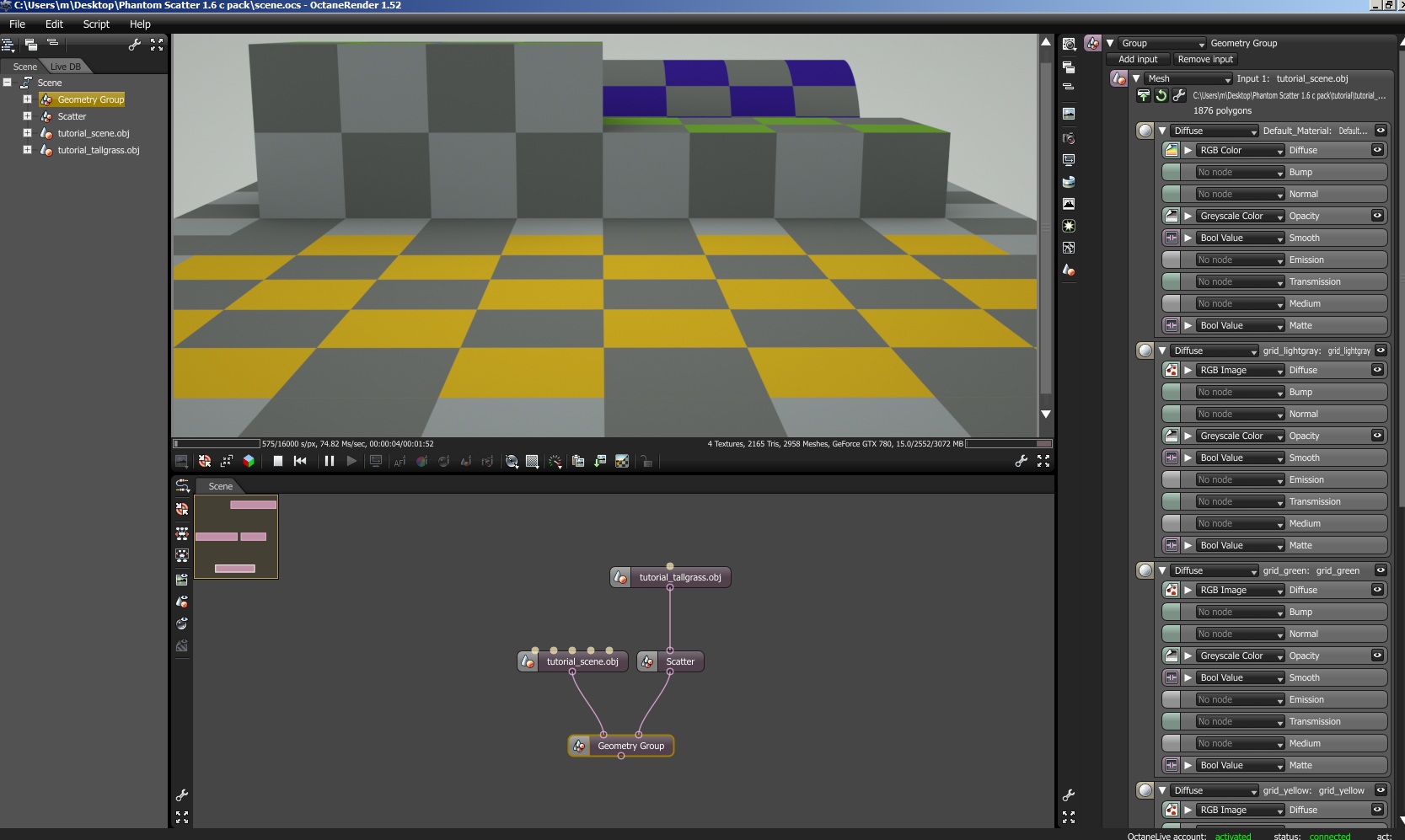

Hi phantom, following your first tutorial I did what explained as it is really straight forward except for the too many OBJ problems I have exporting it from rhino AND from 3dMax, anyway..using your files from the tutorial folder I cannot still get any result as you can see from the picture, am I missing something? scene attached
scene.zip
your tutorial scene complete
(118.45 KiB) Downloaded 150 times
This is what I get, maybe a 1.5.2 problem? will update today and see what I get

That is weird, they are not showing up here either. I think there is something else going on... any opportunity to livestream somewhere? Then you can PM me the link and I'll have a look at the workflow and where it goes wrong. :)
