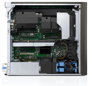

ZAKI wrote:Thanks @glimpse for the feedback, my current machine settings is Dell Precision T5610, Dual Intel Xeon E5-2630 v2, 32GB RAM,3 GB NVIDIA Quadro K4000, do you think it's okey if I throw in another card for a non-custom build machine ? which card of these you mentioned would be the best deal ?
I mainly used this machine for rendering animations so I focused on the number of cores/threads instead of the gpu, that's before I know about octane.

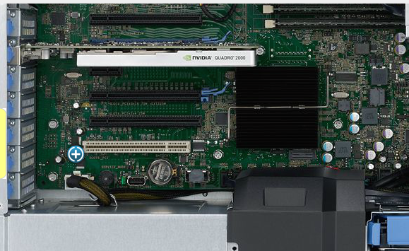

in Your case there's a place for additional card:
considering You don't have too much space for expansion I'd go for TitanZ =) that should a be a ~ 8x boost.
It's hard to tell how much power (PSU) have, so I'd write a line to Dell & ask them exactly to be sure =)
I have a feeling that TitanBlack could be powered easily & even Z..
I would be surprised if dell would put too weak power brick..
but it's worth to ask before making a move!
Hope that helps =)
