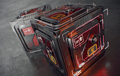

I used the materials from the livedb
1h render time
