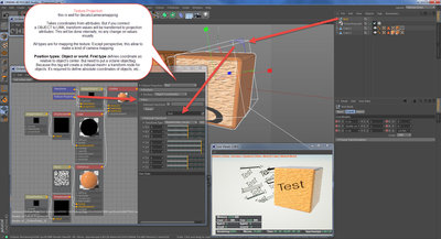

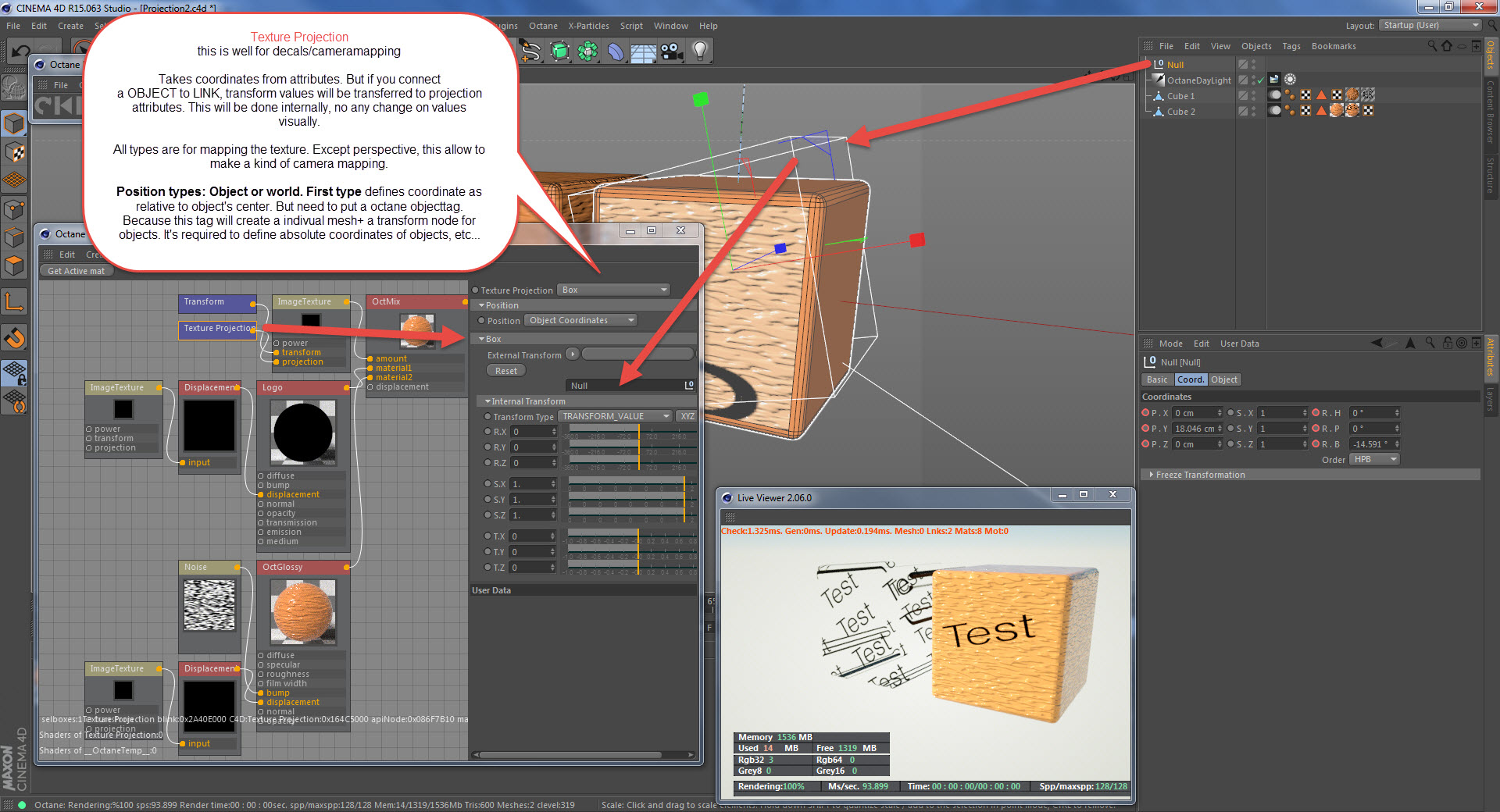

I have done a picture with some explanation. I hope that could be enough to explain process.

aoktar wrote:I have done a picture with some explanation. I hope that could be enough to explain process.
Many thanks, Ahmet.
