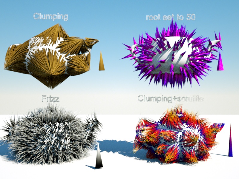

Another test ... i have to precise that primitive used is a cone primitive, and height segment has to be different from 1 otherwise it cannot be bend by parameters. Here heigth segment is set to 6.
hair and fur test
hair and fur test
Win 10 pro 64 / GTX 1070ti, gtx 1070 / FX8320E / 16Go DRR4

hey guys, are you able to see hairs in octane viewport, or just in render window ?
In max 2015 I remember that I can see hairs in octane viewport, but not anymore... :(

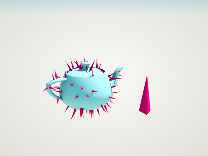

Hey Mist, how can you assign a separate material to teapot?
Mine always gets the same material as the instanced object has.
Suv

suvakas wrote:Hey Mist, how can you assign a separate material to teapot?
Suv
Hi Suv,
First i create a teapot and a primitive, here a cone. I assign a different material on each object, then pick up the cone in instance node and i open octane viewport. These are the steps i use, nothing else.
I specify that i use 3ds max 2015 extension 1.
2 materials
2 materials

HHbomb wrote:hey guys, are you able to see hairs in octane viewport, or just in render window ?
only if i go to hair and fur effects and set type to geometry
HHbomb
Posts: 1438
arggghhh ! Hair and fur in geometry don't work.....
