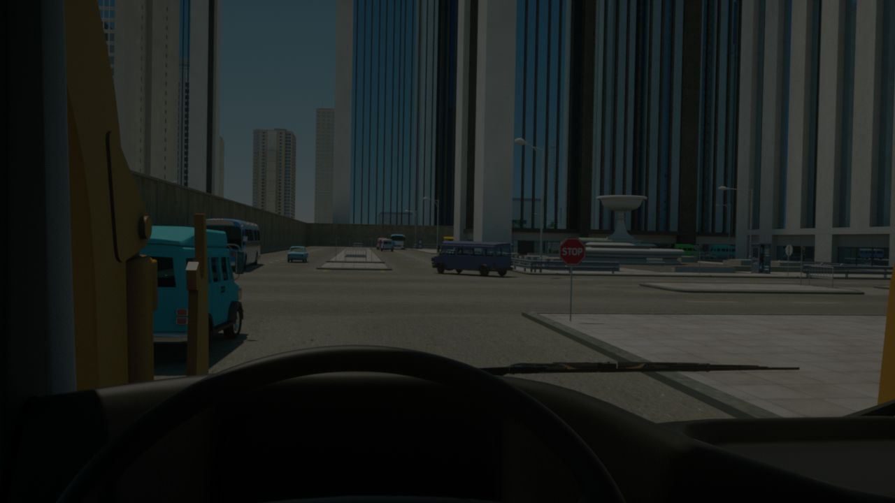

after installing 2.04 this is how first frame always looks like in the animation sequence, unfinished
