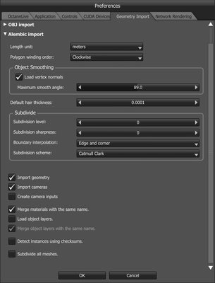

There are a bunch of option to try when loading alembic files into the standalone.
Unticking the "Merge materials with the same name" option might help you dsyee (if you have not already tried it!)

Thanks Fooze - yes, I tried that, but apparently Maya's pipeline-cache export is kind of crap. :roll: I've heard the Octane scene export works well though. But now that v2.0 is out, there isn't as much of a need to export.
