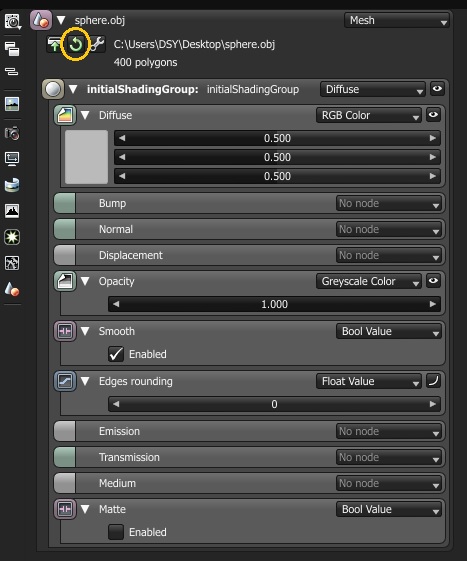

Yes...When you load an OBJ into Octane, it creates a Mesh node that has a file reference. Next to the filename there's a "Refresh" button. So whenever you update the OBJ in your modeling application, you can export it again and hit Refresh and it will update the scene (as long as the file is in the same location).
