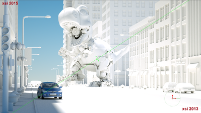

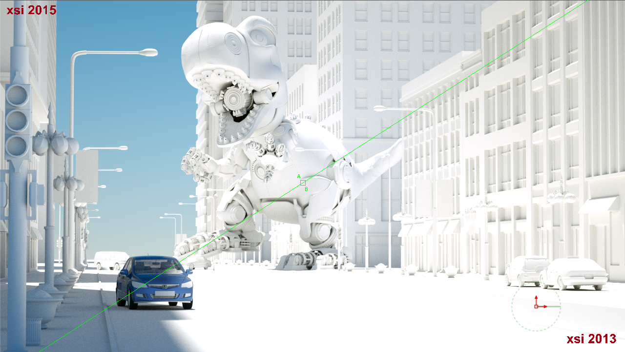

xsi2015 - black preview render and region render, but render status is progress
xsi2013 - works correctly

>>Try to change the display to 8bit.
Сolor management did not help or I do not understand how to change it. Also I final rendered picture in EXR and it is white, but on compositing find color information.

I think i have found the problem. I define different bit depths, which are 8, 16 and 32bit.
The 32bit isn´t used. On 2013 and 2014, which i use to test, all works fine because the standard is 8bit and you can switch it to 16bit over the color management.
Maybe on 2015 the highest bit depth is used, which will be the defined but unused 32bit.
Have disabled it now and hope it works.
To test, you can download the plugin dll and replace it with the one in the addon directory.
If it works, i will update the addon in the first post.

Perfect!!!
That is work.
In xsi2015 also I changed Color Management - Render Pass and Preview for correct gamma view in preview window and gamma correct my image after saving.

The saved image should looks the same or im wrong?
