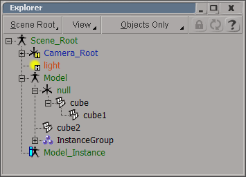

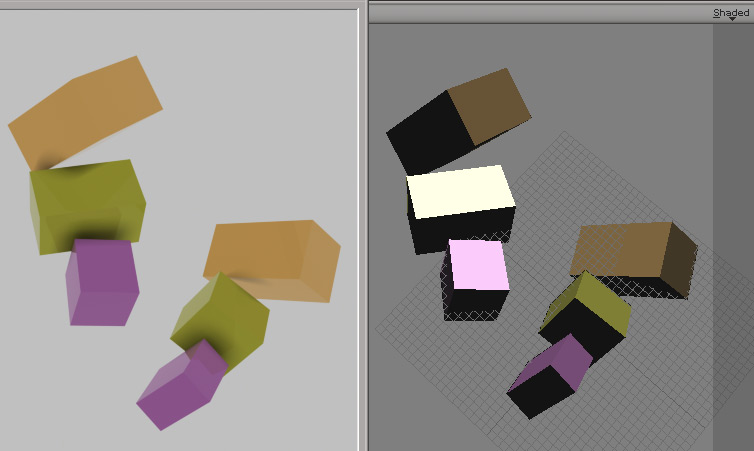

Have found a problem with instances. Instanciated meshes parented to a null, or child meshes from an instanciated mesh aren´t rendered.
This is fixed.
It is now also possible to render instanciated model trees like this:
